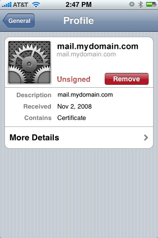

I'm wondering about "sending a certificate" to the iPhone and installing it there. I have done that however it says it "Unsigned" in red text under settings / general / profile on the iPhone.
I'm confused as to WHICH certificate to install on the iPhone. I used the "same one" that I used for the "default webiste" on my sbs2003 server. Not sure it's supposed to be...  anyone???
by: kajbjoPosted on 2008-11-02 at 15:03:23ID: 22863766
Ive put "mydomain" instead of the domain Im working on (obviously) O.o
but this is what the certificat looks like on the iPhone - which obviously seems incorrect
by: tomdlgnsPosted on 2008-11-02 at 15:09:45ID: 22863790
yeah, same exact thing here...

by: LeeOsborneUKPosted on 2008-11-03 at 00:40:50ID: 22865347
Hey Guys,
Just to let you know, I have the certificate installed on my iPhone and that too says Unsigned. However, my iPhone does sync all ok to my Exchange server but you don't actually need to install the certificate as it works without.
Lee

What kind of cert do you have installed? A 3rd party one correct? Thawte? Verisign?
by: tomdlgnsPosted on 2008-11-04 at 06:46:44ID: 22876657
by: tomdlgnsPosted on 2008-11-04 at 09:07:04ID: 22878222
i am still confused.
if SSL is not needed and the cert is not verified on the phone, why would it matter how the certificate is installed?
by: tomdlgnsPosted on 2008-11-04 at 09:09:20ID: 22878236
one thing i just noticed...
i have no idea if this will effect the iphone connecting...or any device that is.
but i just noticed that my cert points to
https://mail.companyname.com
but when i check web mail off of the network i use...
https://mail.companyname.com/exchange
