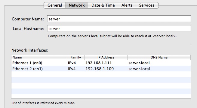

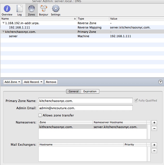

ok here we go I am trying to use the box as a file, calendar, authentication for 2 location (both VPN Tunneled together) at its current state it is fine for the os x boxes. my problen is when i try to get xp boxes to join the domain. i have attached an screen grab of the network tab in server admin.
i have a kitchenchaosnyc.com pointing to my static ip.
by: nappy_dPosted on 2009-11-02 at 08:42:57ID: 25720967
There are two problems I see..you are trying to use a public domain name for your internal clients and your also trying to use a private IP with a public domain name.
We need to clean this up.
  1. your domain name for the xServe and internal network should become kitchenchaosnyc.private.co
  2. DNS: you need to have your internal DNS be the only authority referenced by your internal networked clients
  3. More to follow after we get this cleaned up...

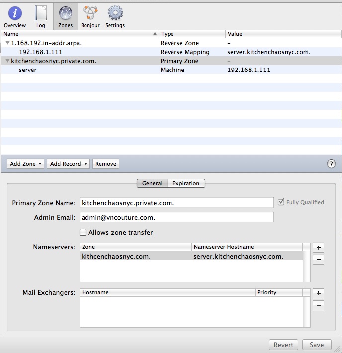

sprry nappy d,
i am in a bit over my head here. is this what you wanted me to change?  and then on all clients set the dns server as 192.168.1.111?
by: ropehawnPosted on 2009-11-02 at 11:17:42ID: 25722635
here is the screen grab
by: nappy_dPosted on 2009-11-02 at 13:20:05ID: 25723863
That is correct.  Your DHCP server should ONLY be assigning your internal DNS from the xServe for all authoritative and non-authoritative lookups.
