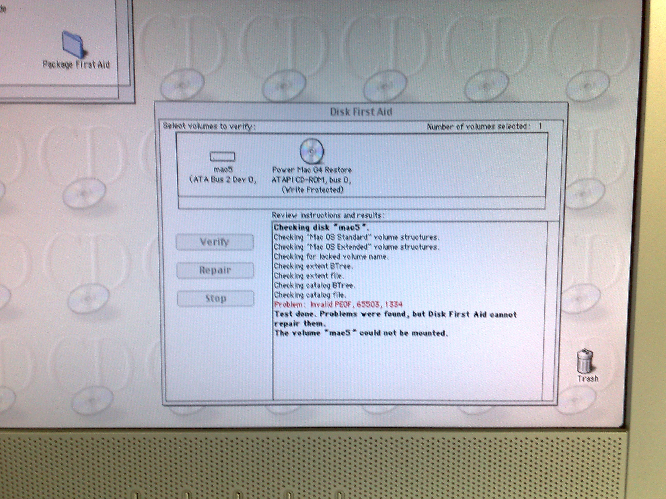

by: steviedeehookPosted on 2008-09-10 at 07:17:12ID: 22438568
Ok....
.When I run the disk repair I get the screen posted below.
It doesn't look healthy.
Steven
by: strungPosted on 2008-09-10 at 07:36:29ID: 22438769
That is bad news indeed. You are going to have to try to locate an older version of a commercial disk repair utility that will run on OS 8 and see if it can repair the drive. I suggest you see if you can find an older version of TechTool:  http://www.micromat.com
