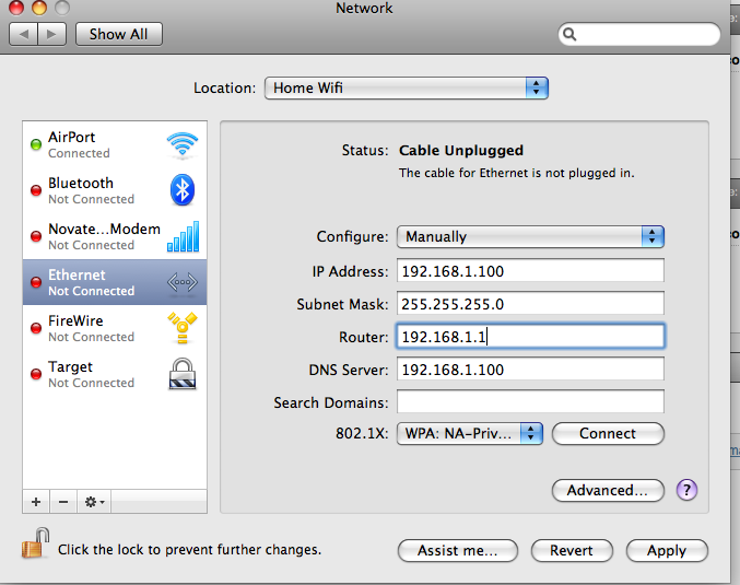

by: nappy_dPosted on 2009-03-03 at 14:18:40ID: 23789449
Go into your system preferences/network
Is should look like this below.  If your router is provisioning IP addresses I do not recommend that you give your server a dynamic IP.
by: xcamaroxPosted on 2009-03-03 at 14:27:34ID: 23789567
My server is in 192.168.1.5 as the static IP and its pointing to 192.168.1.1 as the router and 192.168.1.5 as the DNS... But still nothing...
