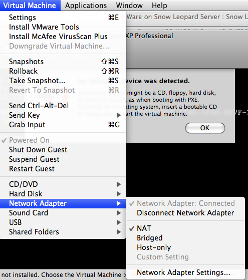

What does your network settings look like?
I would set it to NAT as in the screenshot.
by: nappy_dPosted on 2009-09-11 at 19:11:43ID: 25314770
ooops I meant to show and describe that you have to select Bridged not NAT :)
