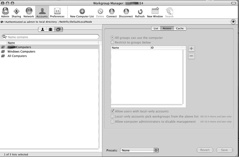

by: steiner470Posted on 2009-09-16 at 18:19:04ID: 25352069
Excellent, I have the implementation working, but there is a small problem. Now that I have my xserve joined to active directory it seems anyone with a valid account can log into the machine! How can I disallow all logins to the xserve except for the administrator account?
by: nappy_dPosted on 2009-09-17 at 18:55:25ID: 25362508
You need to bind your workstations to OD.  After binding to OD, you can create computer groups and nest user groups to computer groups.
This way, you can control who can access which computer(s) or computer groups.  See my screenshot....
