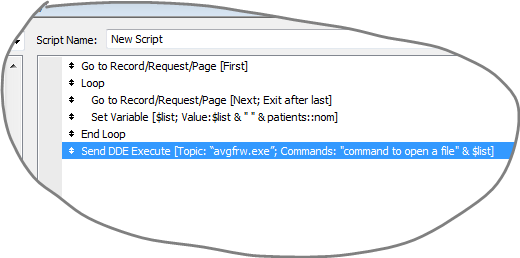

by: lesouefPosted on 2009-06-18 at 06:00:59ID: 24656927
assuming autocad is avgfrw.exe and patients:nom your filename field:
use the capture down there to create a file list if your app accepts it.
So i insist, this info and DDE syntax has to come from autodesk knowlegdeable people.
