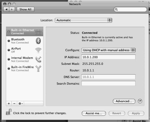

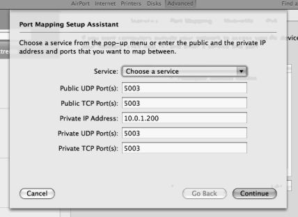

I've got a client I'm working with that has a FileMaker Pro file hosted on a Mac computer.  The computers on his network are behind an Airport base station and I'm struggling to get past it for some reason.
I've attached 1 jpg that shows the current networking config on the host machine and another jpg that shows how I added that rule into the Airport's Port Mappings config.

My client says he's got a comcast cable modem that goes into the airport that goes out to all machines.  Seems very similar to most networks I work with and opening ports on routers and software firewalls has always done it for me.  The OS X firewall is disabled and we've opened the ports on the airport as explained so I'm stumped.

The ports you open are correct. The only one you need is 5003 TCP and UDP.
The settings seem ok.

Turns out my clients cable modem had a firewall built into that was blocking the port so even though we opened it up on the Airport it was never reaching the Airport.  Once I knew it was definitely getting blocked by something besides the Airport I had him call his ISP and they gave him his login info for his modem's firewall and I was able to open the port.  Now everything is working.
