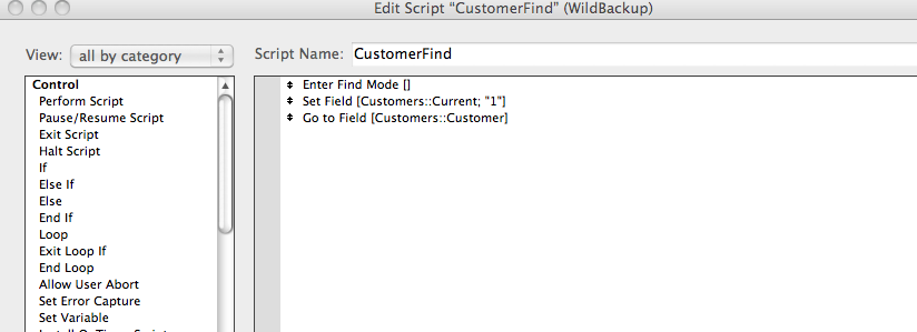

by: kraftymanPosted on 2009-10-11 at 23:25:11ID: 25548896
the script is not correctly written
try this ( screenshot uploaded)
you might want to customize the find button for comperes, customers, shifts, pulse and games,
I found myself clicking the find button rather than looking at the menu
by: afbaerPosted on 2009-10-12 at 18:38:59ID: 25556406
Thanks but can you make this script work on my database? This is where I started some while back before trying more exotic solutions and I still get the same result: the "Current" checkbox remains unchecked and I get a zero in the Customer field. Same happens on the other computers sharing this database. If you can make this work and I can't, I can only assume my FM program is corrupt. By the way, the script is only a menu item while I am messing around with it.
by: North2AlaskaPosted on 2009-10-12 at 19:15:42ID: 25556527
I think I see the problem with your script.  Look at the script step options area at the bottom of the script when you select the assignment.  You have not specified a target field.  The calculation is incorrect as well.  The calculation says "Customers::Current=1".  This is a formula not an assignment.  So, it tries to evaluate the formula.  It asks the question is Customer::Current equal to One.  The answer is no (or false) so it puts a zero in the field.  Your script step should look like this:
Set Field [Customers::Current, 1]
by: afbaerPosted on 2009-10-12 at 19:21:58ID: 25556547
Wonderful! Thanks so much!
