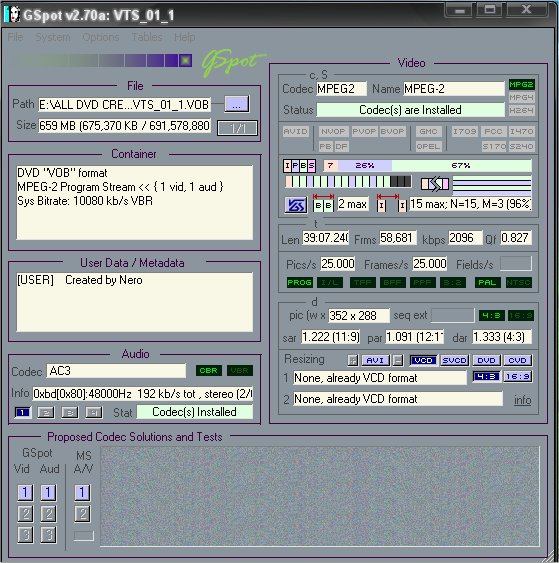

What i'd like to see is the  pics/frames you used.
here is a snapshot of a vob on gspot from a DVD I made, I am in Australia though.  So use Pal.
by: MeretePosted on 2008-03-27 at 03:01:31ID: 21219804
interesting difference, is this HD? Or a standard DVD?
Well I see your picture width differs all your settings differ, I think it's imovie using the video you gave it to re-author it
pic (w x) 720 x 576 ---mine 352x288
seq ext 720 x 576 -- none
sar 1.250 (5:4) ----- 1.222
par 1.422 (~10:7)

by: rpc800Posted on 2008-03-27 at 05:27:46ID: 21220531

One thing that is suspicious is that 720:576 width/height ratio, << agree and I think that's the key.
Looks like it's converting mpeg4. Not mpeg1 or mpeg2
I am certain that the image that the TV receives is already a 4:3 image, it isn't cropped by the TV.<< I agree
Looking at your gspot details you supplied
your SAR 1.250 (5:4) << mine> 1.222 (11.9)
your dar 1.778 (16:9)<<mine> 1.091(12.1)
16.9 is mpeg letterbox conversion.
If you multiply the SAR by the PAR you get the DAR (display aspect ratio).
