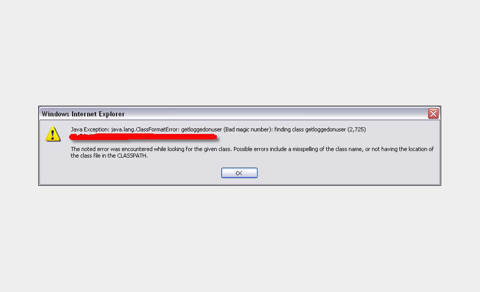

by: tgatifPosted on 2008-05-20 at 11:19:40ID: 21608757
I used eclipse to create a project and then the jar file with teh code above. seems to create thejar file but when i invoke it, i get errors about java exception: bad magic number.
by: CEHJPosted on 2008-05-20 at 11:35:45ID: 21608903
You probably are compiling it with too high a Java version for the runtime you're running it on. Compilation must have Eclipse compliance set to <= your applet runtime

by: tgatifPosted on 2008-05-22 at 10:18:14ID: 21625752
This is the error I get. I have checke dthe version is 1.4 whcih is what i have.
i have also added the path in teh classpath environmental variable.
attached is the file of the error.

by: tgatifPosted on 2008-05-22 at 11:58:53ID: 21626593

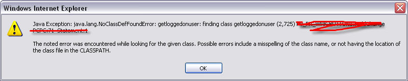

i just realized something. when i create a jar file and put it out there. it gives me a different error. but with the class file, it gives me the bad magic number. I dont know how to create a class file alone in ecl;ipse. i go to export. then pick as jar file and then pchange teh name to .class instead of .jar. is this correct
    • 27 KB
    error when i have a jar file out there. seems canot find jar
by: tgatifPosted on 2008-05-22 at 12:05:23ID: 21626655
it worked. i grabbed teh correct class file and we are good to go. however, it brings in the userid of the server lopgon where the class file is located. i need the client username.
