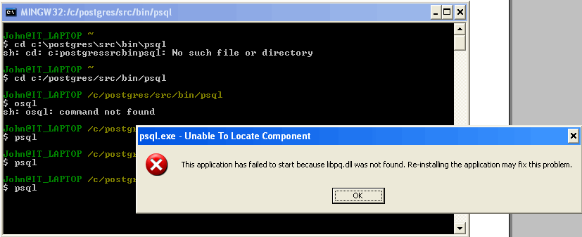

I am trying to switch from VB to C++. My first step is to try and connect to Postgresql from C++, but I have no idea how to do this.
I have followed the instructions here: http://pqxx.org/development/libpqxx/browser/trunk/win32/INSTALL.txt?rev=latest (I followed the parts between lines 172 and 202).
Anyway, when I try to run psql, I get the error in the image below...
Any idea why this error comes up? I've installed from source, not sure if I missed something.
Also, is there an easier way to connect to Postgresql from C++? I can't imagine my largely PC not-so-literate clients doing installations of these packages from source...

by: jkrPosted on 2009-10-19 at 11:23:11ID: 25607686
Do you have libpd.dll on your machine? If not, you'll need to get it and place it in the directory of the executable. You can get the binaries from http://www.postgresql.org/download/windows
by: JSMCMPosted on 2009-10-19 at 23:05:21ID: 25611350
It actually didn't install with the rest of the installation. I copied from the source you mention in the link.

by: jkrPosted on 2009-10-20 at 13:38:29ID: 25618318
>>The real problem that I have is that this solution is not feasible to provide as
>>is to my clients. I can't expect them to install software like this.
That's clear. When you're done developing, you'd usually create an installation package where you include these binaries, that's what you distribute to your clients.
by: JSMCMPosted on 2009-10-20 at 21:06:31ID: 31643754
Hi jkr,
Thanks, I managed to get this to work by downloading the dll's from the location you pointed to.
