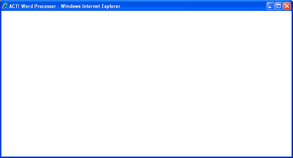

Hello,
We have had ACT!  Premium for Web (Version 8.0.2.42, 2006) running on our server for years.  Then starting yesterday afternoon whenever you go to:
Write-->Other Document (From Template)
Select a template and open it.
A blank white window opens and it just hangs, never loading the template.
These templates where working fine 2 days ago.

by: Razzmataz73Posted on 2009-11-05 at 07:00:50ID: 25750134
I turned everything completly off and I get the same thing.
Write-->New document and I get this popup that stays with the thinking hour glass and never brings up the controls.

New info.
I just logged into the server and opened the ACT8Demo database and tried to write a document from there and got "The RPC server is unavailable", and then "Exception of type System.OutOfMemoryException was thrown".  I ok'd out of them and the ACT word processor came up.  Could that be related to the issues we are having when trying to open the ACT! Word Processor through IE?
by: Razzmataz73Posted on 2009-11-11 at 06:19:10ID: 31649987
It was update related.  We have a dedicated server with Godaddy but can only do a restart remotly.  I had them turn the computer completly off (whch it looks like some of the updates neeeded), and then turned back on.  And poof!  It now works.
