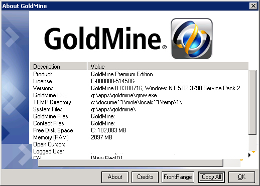

Here's the System Info from within Goldmine
by: BenthamLtdPosted on 2009-10-01 at 14:00:33ID: 25473190

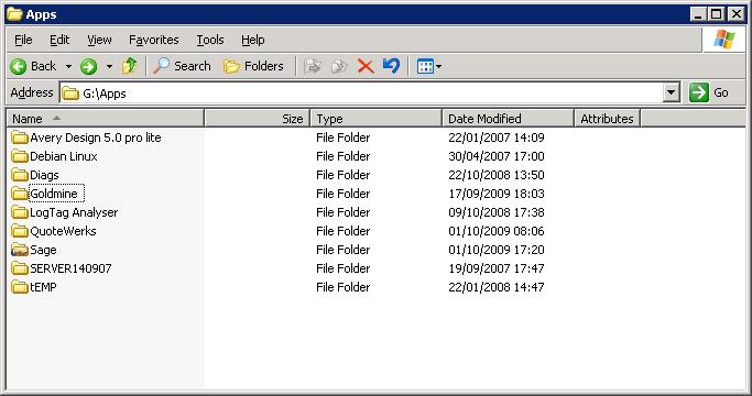

It looks to me like Goldmine has been installed on the G:\ Drive of the server.
I think all clients have the G:\ Drive mapped as a network drive as well, shared from the "apps" folder.

Ok this helps alot.
I can see GoldMine is using the dbalias.ini entry "GoldMine" and its an 8 user system.

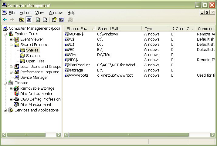

The old server has a mapped drive letter to itself, so the Application is most likely on the C or D drive and that location is shared.
It is good practice to use the same drive letter on the server when running the application as goldmine will store the full path to attached files and so you would need the same path for all users.
You should be able to tell the actual mapping by looking in the mappings list which can be found by right clicking on the "My Computer" icon and select "Manage"
See screen shot
All clients should really have the same mapping for consistancy.
