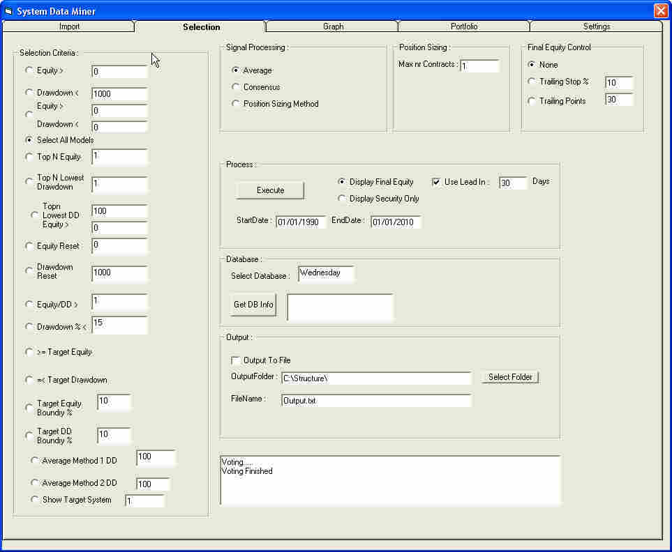

by: SchuttendPosted on 2009-01-21 at 06:55:01ID: 23430148
Please find enclosed :
1. Screenshot of my application with tested selecting criteria
2. A file with a target system. This system is good enough for selection. With other words, this would be the needle in the haystack.
9999 bad performing models and 1 good one which has to be found.
