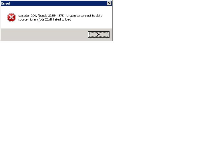

New information: I attempted to use the 'Users' tab on the Firebird ODBC Service dialog. On clicking the 'Get Info' button, the following error message is produced:
    • 15 KB
    Error produced within Firebird 64-bit ODBC Users dialog
by: QlemoPosted on 2009-11-25 at 08:09:58ID: 25908379
If you start the ODBC Administrator via Start Menu, it will use the 64bit version of odbcad32.exe (in system32, while the 32bit version is in SysWOW64). Both executables have the same name.
by: netperfPosted on 2009-11-25 at 08:14:58ID: 25908428
We were just having the exact same problem.  Ran the odbcad32.exe located in C:\windows\SysWOW64 and then the connection succeeded.
by: ukjerry2Posted on 2009-11-25 at 08:50:14ID: 31658700
The question not asked, but which proved critical, was whether the user application was a 32-bit 0r 64-bit app. As it turned out, because it was a 32-bit app, use of the 64-bit Firebird driver was inappropriate. This meant that the 32-bit driver had to be used, and thus Olemo's observation re the respective location of the relevant odbcad32.exe files was the key to unlocking this puzzle
