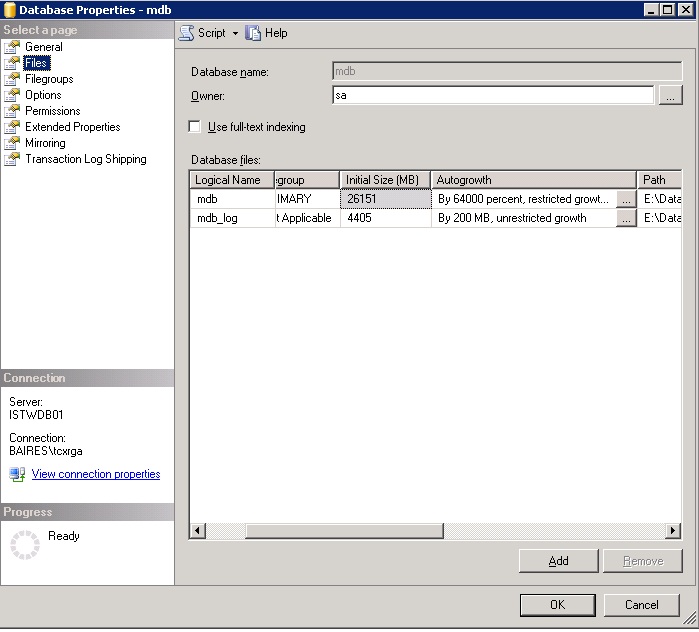

Asked by: gbecerra
I have a problem with Autogrowth, how can i force autogrowth to 10%.
Now Autogrowth=64000%

HI
alter database <your db name>
	modify file (name = <your db name>,  FILEGROWTH  = 10)
by: gbecerraPosted on 2009-11-03 at 05:25:25ID: 25728635
Thanks but with this article can modify the size of the file but not the % of autogrowth.
by: mwvisa1Posted on 2009-11-03 at 05:34:40ID: 25728724
May have already been answered, but one simple approach since you have the screen open (from your screen shot), you can just click on the "..." (ellipsis) button and change the growth properties there.
by: gbecerraPosted on 2009-11-03 at 05:35:59ID: 25728735
No, becuase when i modify the value i recive a error becuase 64000% is more tha maximum % allowed
by: mwvisa1Posted on 2009-11-03 at 05:37:15ID: 25728742
?? But I thought you were changing to 10% ??
by: mwvisa1Posted on 2009-11-03 at 05:38:48ID: 25728756
At any rate, think someone showed the SQL approach above.  Was just figured since you had the SQL Management Studio window open to the properties of the files that you could just set it there.
by: gbecerraPosted on 2009-11-03 at 05:53:02ID: 25728877
thank you very much, when I change this value percentage changes Mb.
