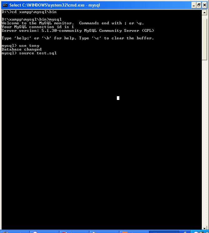

by: jack_Posted on 2009-08-28 at 06:18:56ID: 25207285
I u have skype then please quit the application.(the port has been blocked if u open skype)
Where ur mysql is installed. I mean this file (mysql.exe) .In my system i have installed in
D:\xampp\mysql\bin\mysql.exe
I placed my test.sql file in the same path as mysql installed D:\xampp\mysql\bin
now i am using the command prompt
Go to run and type "cmd"
u where there now.
Then go to the path "D:\xampp\mysql\bin"
use the cd command to switch directory.
normally it takes to the path
C:\Documents and Settings\jack>
now i type "D:"
so C:\Documents and Settings\jack>D:
now the prompt change to d:\>
then cd xampp\mysql\bin
now my prompt is here
D:\xampp\mysql\bin>
Type mysql there
D:\xampp\mysql\bin>mysql
the prompt takes u to mysql
mysql>
then type the database name.
mysql> use databasename
Database changed
mysql>source test.sql
my database name is tony...
U are set...
Hope this will help u.
Let m eknow if u face any issues.
jack

by: jack_Posted on 2009-08-30 at 01:11:43ID: 25216736
by: DanielAttardPosted on 2009-08-30 at 19:46:03ID: 31622365
