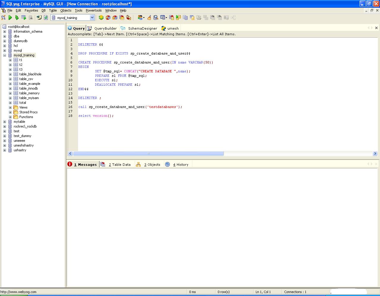

by: ushastryPosted on 2009-09-23 at 04:26:14ID: 25401847
Try this...
DELIMITER $$
DROP PROCEDURE IF EXISTS sp_create_database_and_user$$
CREATE PROCEDURE sp_create_database_and_user(IN name VARCHAR(50))
BEGIN
        SET @tmp_sql= CONCAT("CREATE DATABASE ",name);
        PREPARE s1 FROM @tmp_sql;
        EXECUTE s1;
        DEALLOCATE PREPARE s1;
END$$
DELIMITER ;
call sp_create_database_and_user('umeeee');

by: girionisPosted on 2009-09-23 at 04:57:08ID: 25402070
Right, ushastry your code does work when I try it from command line, so I guess there was a problem with the client I used. I will do a split and allocate most points to you.

by: angelIIIPosted on 2009-09-23 at 04:57:27ID: 25402074
how do you RUN that code? the DELIMITER stuff is for mysql command line, if you use some mysql tools, you won't need that part...

by: ushastryPosted on 2009-09-23 at 05:30:19ID: 25402299
You can use DELIMETER  from mysql propt as well as from any GUI tools... The delimiter command changes the string that mysql interprets as the separator between SQL statements. The default is the semicolon character (;).
