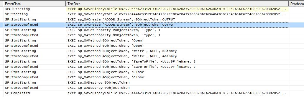

by: brigzyPosted on 2009-11-09 at 01:04:05ID: 25774323
SQL trace : no errors, but no file created ?
