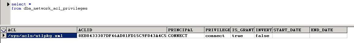

by: sdstuberPosted on 2008-03-13 at 15:24:47ID: 21121415
what do you get from
select * from dba_network_acl_privileges
by: darren_k156Posted on 2008-03-14 at 03:49:32ID: 21124261
Here I took a screenshot of the result...
I know there's a where clause in the screenshot but I removed it and re-run the query and the result was the same (and it was run using the SYSTEM account)
by: darren_k156Posted on 2008-03-14 at 04:48:00ID: 21124532
Ok I'll try posting the response again but this time using the query you asked for ;-)
by: darren_k156Posted on 2008-03-14 at 04:50:04ID: 21124541
And here it is...
by: sdstuberPosted on 2008-03-14 at 06:31:51ID: 21125282
grant resolve as well
by: darren_k156Posted on 2008-03-14 at 08:08:23ID: 21126221
Thanks!
by: darren_k156Posted on 2008-03-14 at 08:09:34ID: 31439000
Thanks very much for your help, that was spot on!
