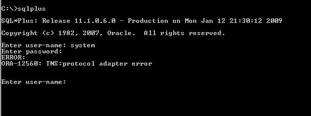

by: sdstuberPosted on 2009-01-12 at 07:45:22ID: 23354129
when you connect with sqlplus you should get something like the snippet below
what are your typing at the prompt that generates the error?
Can you cut and paste your screeen text?
SQL*Plus: Release 11.1.0.6.0 - Production on Mon Jan 12 10:43:16 2009
Copyright (c) 1982, 2007, Oracle.  All rights reserved.
Enter user-name:
by: ijeevanPosted on 2009-01-12 at 07:57:35ID: 23354276
yah sure,
by: sdstuberPosted on 2009-01-12 at 08:00:40ID: 23354321
that's the problem,  you're not specifying the database you want to connect to
try
"system@orcl"
by: ijeevanPosted on 2009-01-12 at 08:03:17ID: 23354356
Wow... It worked :-)
Thanks a lot.
by: ijeevanPosted on 2009-01-12 at 08:06:18ID: 31533486
The answer was perfect.
by: sdstuberPosted on 2009-01-12 at 08:08:07ID: 23354405
glad I could help
