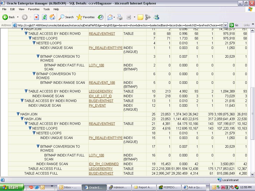

this update statement is taking forever.  The explain plan is attached.
INSERT INTO LEDGERENTRY_TEMP( LEDGERENTRY_ID,CONN_ID) SELECT LEDGERENTRY.LEDGERENTRY_ID, :"SYS_B_0" FROM LEDGERENTRY,BUSEVENTHIST,BUSEVENTDEF,REALEVENTHIST,REALEVENTDEF,REALEVENTTYPE WHERE (LEDGERENTRY.BUSEVENTHIST_ID=BUSEVENTHIST.BUSEVENTHIST_ID AND LEDGERENTRY.REALEVENTHIST_ID=REALEVENTHIST.REALEVENTHIST_ID AND BUSEVENTHIST.BUSEVENTDEF_ID=BUSEVENTDEF.BUSEVENTDEF_ID AND REALEVENTDEF.REALEVENTDEF_ID=REALEVENTHIST.REALEVENTDEF_ID AND REALEVENTDEF.REALEVENTTYPE_ID=REALEVENTTYPE.REALEVENTTYPE_ID) AND (REALEVENTTYPE.REALEVENTTYPE_ID = :"SYS_B_1" OR REALEVENTTYPE.REALEVENTTYPE_ID = :"SYS_B_2" AND REALEVENTHIST.PROCESSING_TYPE_ID != :"SYS_B_3" AND LEDGERENTRY.ISLEDGERENTRYADJUSTED = :1 AND REALEVENTHIST.REALEVENT_DTM > :2 AND LEDGERENTRY.LOT_ID= :3 AND REALEVENTHIST.REALEVENT_DTM <= :4)

I don't know if you have up-to-date statistics, but the last two lines in the explain plan gives a clue as to possible ways to improve this.  The LEDGERENTRY table has two references in the where clause to specific values:
I assume the first one is a Y/N value, but if the lot_id is fairly distinct then an index on that allow the query to use an index on LEDGERENTRY.
Does BUSEVENTHIST.BUSEVENTHIST_ID have an index?  that would speed things up.
Finally, what role do the other tables (BUSEVENTHIST,BUSEVENTDEF,REALEVENTHIST,REALEVENTDEF,REALEVENTTYPE ) play in the query since they don't contribute to the where clause.  Often it is more efficient to use EXISTS instead of a complex join.  Or, join some of the tables in subqueries and join the result to just one or two tables (that whole REALEVENT... relationship could probably be joined together first and then just join the result to the LEDGEREVENT or BUSEVENT).
Good luck!

Indexes were there.... just optimizer not picking them up.  Can not hint code.  Ran fresh stats..still not picking them up.  Running all_rows not cost.
by: DrSQLPosted on 2008-08-06 at 12:43:14ID: 22174249
Actually, it's FIRST_ROWS or ALL_ROWS and RULE, CHOOSE, or COST but I think I knowwhat you mean.  The OR could still throw it off.  Let me see if I can do some of what I suggested.  Give me a couple of minutes and we'll see if we can convince it to use what's there.
