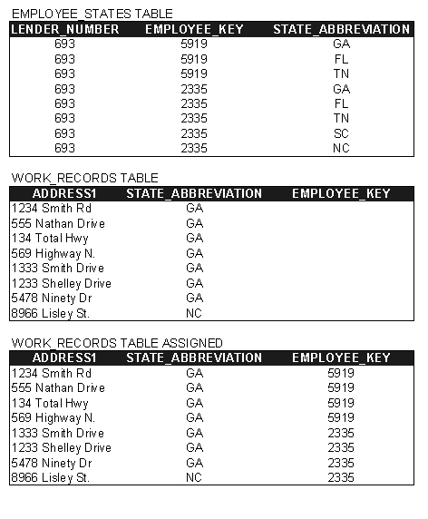

I need help in PL/SQL assigning employees to records based on client and state.
I have a table called EMPLOYEE_STATES with the employee number and the states and client assigned to that employee.
I have a table called WORK_RECORDS with addresses and loan information and employee field.   These records are currently unassigned to any employees.
I need to assign employees to  WORK_RECORDS based on the state and employee in EMPLOYEE_STATE.
So, If two employees are working the same state, I need to divide up the work.
Attached is the EMPLOYEE_STATES, WORK_RECORDS and WORK_RECORDS assigned.
Please help me write a stored proc to do this.

by: sdstuberPosted on 2008-12-02 at 21:56:10ID: 23083544
you don't need pl/sql,  you can do it purely with sql.
This won't necessarily create the same sorting in the distribution, but it will create an even distribution.
If sorting is important, it can be modified with the row_number "order by" clauses

by: nav_kum_vPosted on 2008-12-02 at 22:58:23ID: 23083746
Hi ksummers,
I can understand your question but before i propose some solution/advice, i need to understand as to how did you arrive at the below.
in work_records table,  you have 7 records for state GA and you have two employees working in that state namely 5919 and 2335 but
1) how did you decide that first 4 records should go to 5919 and the remaining 3 records should go to 2335 ? any rationale behind this ?
OR
2)  it is just that you have 7 recoreds and 2 emps, you gave some 4 to one emp say 5919 and the remaining 3 to emp 2335
So can you answer whether you pick 1 ) or 2) from this.
by: ksummersPosted on 2008-12-03 at 06:31:54ID: 23086127
sdstuber - i will try your select and let you know how it works.  i believe that will work as long as there is some sort of even distribution.
nav_kum_v - thank you for your questions.  that is what i am trying to arrive at, achieving some sort of even distribution in my sql.  if two employees are assigned the same state, then i need to divide the assignments up some sort of way.  it does not need to be a perfect distribution.
by: sdstuberPosted on 2008-12-03 at 06:43:22ID: 23086261
yes it does an even distribution, or as even as it can.  If you have 2 employees and 5 locations, one of them will get more work.
