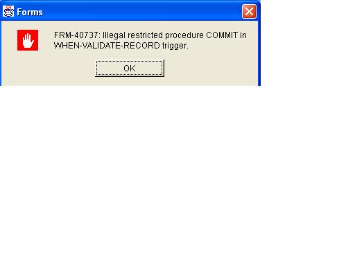

    by: wasabi3689Posted on 2009-09-17 at 09:41:40ID: 25358161
    according to http://www.orafaq.com/forum/t/55789/2/,  I add the following to the code
                if name_in('SYSTEM.RECORD_STATUS') = 'CHANGED' then
                    COMMIT;
                  END IF;
    When I open the form and find a record, it has this message popped up as attached image. I click on OK but it never give me to close the form anymore
    by: nav_kum_vPosted on 2009-09-17 at 18:20:32ID: 25362418
    you cannot use  any restricted builtins in the validation triggers. you also cannot use go_block(..), go_item(..) are also restricted
    by: wasabi3689Posted on 2009-09-17 at 18:38:39ID: 25362459
    So, what is your solution? how to get rid of this message

    by: HenkaPosted on 2009-09-17 at 22:52:00ID: 25363174
    Is it about this message " "Do you want to save the changes you have made" Yes, No, Cancel " ? If it is so, then it means that in your form there is at least one record with status NEW or UPDATE. Do you want to change records in this form ? If yes then the message is right. If no then you ought to see post-query triggers and if there are any assignments then put
    set_record_property(:system.trigger_record,:system.trigger_block,status,QUERY_STATUS);
    at the end of code.
    To your quick question about copy( ' ', 'order.attribute14' ) - this is all right. If you use this statement and the item is not empty then there is another problem.

    by: wasabi3689Posted on 2009-09-27 at 19:03:49ID: 25436381
    Hi everyone,
    Let's forget the point how to fix copy a null value to a flexfield.I think it's a bug in Oracle form and it's not fixable. I have found a way to get around it. I use N/A to represent null, not use null. It works fine and my team is OK with it.
    Now, let's focus on this problem. I still have this message "Do you want to save the changes you have made" Yes, No, Cancel " ? bother me when I close the form.
    How to get rid of this message when I close the form
    IF name_in('SYSTEM.RECORD_STATUS') = 'CHANGED'
                and event_name = 'WHEN-VALIDATE-RECORD'
                then
                      EXIT_FORM(NO_COMMIT, NO_VALIDATE);
    end if;
    If I put the following code, it will come another message "close form" yes, no, cancel and the tool message bar will come up
    frm-40737:illegal restricted procedure exit_form in when-validate-record trigger
    So, how to fix this problem - get rid of message
    or
    by: HenkaPosted on 2009-09-27 at 22:52:08ID: 25436912
    Your problem is caused by changing the status of record from QUERY to CHANGED. I think that it is done by your new added code
    copy( p_tax_status, 'order.attribute14' );
    Here you change the value of item attribute14 in block order.
    If you don't want to save changes then you must change the status of record programmatically from changed to query by this statement:
    set_record_property('1','order',status,QUERY_STATUS); -- here I put '1' as record number

    by: wasabi3689Posted on 2009-09-28 at 15:21:10ID: 25444126
    Still doesn't work
    I use your line set_record_property('1','order',status,QUERY_STATUS);
    When I open the form and query a record like customer_number, I cannot input the whole number such as 667654, the field only shown one digit in a second, I cannot query this record by query->enter. I don't understand what '1' used for.  You mentioned in your previous mail "these are known in form - some variables from your library or directly.." what doesn't mean?
    Then I use the following code,
    Set_Record_Property (NAME_IN ('SYSTEM.TRIGGER_RECORD'),
                           NAME_IN ('SYSTEM.TRIGGER_BLOCK'),
                           STATUS,
                           QUERY_STATUS);
    It has the same problem as i use '1' line you gave me.
    The I use
     IF name_in('SYSTEM.RECORD_STATUS') = 'CHANGED' and
                event_name = 'WHEN-VALIDATE-RECORD' then
                           STATUS,
                           QUERY_STATUS);
                   END IF;
    It works and the asking save message is gone. But the problem is when I want to change an existing  record and save it, it cannot allow me to do that and come up with the error as attached. When I hit Ok, still cannot save.
    What I want is when I don't change anything and just view the data and close the form, no asking save. But if I update an existing record and either go action-> or directly close the form, will ask me if wanting to save the record.
    I guess I need to switch around the mode changed->query->new...But I cannot overcome this error message or asking save message popped up even I don't change anything.

    by: wasabi3689Posted on 2009-09-29 at 07:46:44ID: 25449611
    so, what is the solution? and how to modify the code?
    by: HenkaPosted on 2009-09-29 at 22:38:53ID: 25455874
    It is difficult to say what you can do.
    Where is this code ?
                           STATUS,
                           QUERY_STATUS);
                   END IF;
    I think that if it is coming during WHEN-VALIDATE-RECORD trigger is firing then it is the problem (FRM-40654 error).
    All you can do is debug your form.
    by: wasabi3689Posted on 2009-09-30 at 15:11:07ID: 25464166
    this code is located in custom.pll.
    Yes, you are right. it's coming during WHEN-VALIDATE-RECORD trigger is firing then it is the problem (FRM-40654 error).
    Debug my form? this is difficult
    The form is not custom form and it's built-in form and how can I debug the form? Do you have other solution to get rid of "Do you want to save the changes you have made" Yes, No, Cancel " ? but at the same time, I can update/change a existing record?
    by: HenkaPosted on 2009-09-30 at 22:33:21ID: 25466174
    I think that if you change item's value then "Do you want to save ..."  will always come.
    So I would put away
                           STATUS,
                           QUERY_STATUS);
    so user can update the existing record.
    by: wasabi3689Posted on 2009-10-01 at 07:36:04ID: 25469102
    But, the problem is when user just look at the record and don't make any changes, this message will always there too if I remove the set_record_property.
    by: HenkaPosted on 2009-10-01 at 22:31:13ID: 25475383
    Yes, it is true. But if you change the item's value then it is changed item.
    I ask you
    "Where is this code called from ?
                           STATUS,
                           QUERY_STATUS);
                   END IF;
    I know that it is located in custom.pll.
    When and where you use your new code ?
    The best you can do is calling your code in when-new-form-instance trigger after execute_query or in a post-query trigger.You have to remove
    from the condition.
    by: wasabi3689Posted on 2009-10-06 at 14:48:22ID: 25510276
    Ok, after I put the following code, without using this
                           STATUS,
                           QUERY_STATUS);
    everything seems working now.
     if (p_tax_status is not null and p_ship_to_location is not null
                and name_in('SYSTEM.RECORD_STATUS') = 'CHANGED'
                and event_name = 'WHEN-VALIDATE-RECORD' )  then
              elsif (p_tax_status is null and p_ship_to_location is not null
                copy('N/A', 'order.attribute14');
              end if;
    So, I will wait for few days for testing and will close this ticket with points for every one.
    by: wasabi3689Posted on 2009-10-08 at 09:33:16ID: 31625837
    Althought your answers are not exact to the solution, your inputs either hit the edge of the solution or provide valuable clues for me to try.
    Thank you so much.
