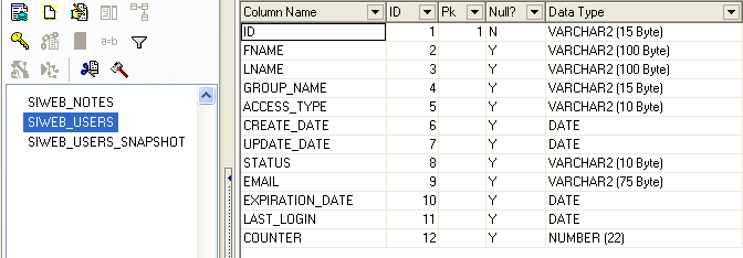

Hi Experts,
          I need your help in figuring out this problem.
              So on this new web module, we have a section where admin can track how many users
              logged on to the website in a given frame of time.
              For this I have a java code, which captures users ID and LOGIN TIME and dump in a
              table(Snapshot attached).
              When the user logs in the second time, LAST_LOGIN_TIME and LAST_LOGIN_TIME_2(time before
              current login) updates using Java code.
              Now the problem I am facing is, how to implement a logic for counting, "How many users logged
              on to the website in a given frame of time (supllied from Web Interface)".
              Your help is highly needed.

by: mrjoltcolaPosted on 2009-10-30 at 12:10:41ID: 25705965
I do not think I would update the previous records, I would simply log every login to the table and then write whatever queries against that log to produce the necessary report.
Then your case above simply becomes:
select user_id, name, max(login_time), count(1) from tracking
  group by user_id, name
by: mrjoltcolaPosted on 2009-10-30 at 12:11:54ID: 25705976
And this is why.
              current login)
That is denormalization that is not good for the design and presents problems in itself.
by: kadabaPosted on 2009-10-30 at 12:13:10ID: 25705980
try something like this...
select count(*) from table_name where last_login_time >= start time frame and last_login_time_2 <= end time frame
by: aman0711Posted on 2009-10-30 at 12:13:51ID: 25705992
Hello Sir,
                Thanks for your input. So you mean to say, instead of keep updating the same row again and again and using some sort of Counter.
               I should, create a record every time, user logs in?
by: aman0711Posted on 2009-10-30 at 12:14:33ID: 25705998
Hi Kadaba,
                 Just this query would do?
by: mrjoltcolaPosted on 2009-10-30 at 12:17:04ID: 25706014
Yes. Because there are other requirement that might come down the road, like tracking if a user's IP address changes, or tracking login history in a granular detail that your current schema cannot manage. You are using a single record as a "2 - login rotating queue". Don't do that. Use each login as a new record, just like Oracle auditing does it.
by: mrjoltcolaPosted on 2009-10-30 at 12:18:11ID: 25706021
I've designed lots of these systems where auditing is a concern. Trust me, it will make your life easier.
by: mrjoltcolaPosted on 2009-10-30 at 12:19:50ID: 25706034
So if you take my advice and fix the table:
>> "How many users logged on to the website in a given frame of time (supllied from Web Interface)".
Would be:
select count(distinct(user_id)) from tracking where login_time between ? and ?
by: aman0711Posted on 2009-10-30 at 12:20:18ID: 25706036
Hello Sir,

by: aman0711Posted on 2009-10-30 at 12:21:33ID: 25706049
Sure,
          I will follow your advice,
         Can you do it step by step?  please :)
        First step.. you want me to drop LAST_LOGIN_TIME_2 column?

by: hieloPosted on 2009-10-30 at 12:24:01ID: 25706061
Correct. WIth what you have now, if I logged in on June 1 and then again on Oct 1, you will not be able to answer the question ""How many users logged on to the website in a given frame of time". Since you will only know that the last time the user logged in was Oct 1 and you will know that there have been 2 total logins since the beginning, but you won't now if it were between Sept 1 - Oct 1, or Jan 1 or Oct 1, etc.
You need a separate table
Tracker
Person_id | login_date
if you execute:
SELECT COUNT(*) as total FROM Tracker WHERE (login_date BETWEEN '2009-06-01' AND '2009-10-01') AND Person_id=3

by: aman0711Posted on 2009-10-30 at 12:26:52ID: 25706080
Hi hielo,
                Thanks for guiding me :-)
                Can you please tell me "why I need a separate table?"
by: hieloPosted on 2009-10-30 at 12:28:13ID: 25706090
>> Actually one of my colleague suggested me to use 2 tables:
Exactly!
>>1- First one that I posted above.
Not EXACTLY like that. That table does NOT need LAST_LOGIN_TIME and LAST_LOGIN_TIME_2
You only need LAST_LOGIN_TIME on the SECOND table.
Read my previous comment for the second table

by: aman0711Posted on 2009-10-30 at 12:32:14ID: 25706116
Seniors,
               I got the basic logic and its very clear in my mind now. BUT:
               I am confused which approach to follow, like mrjoltcola said, only oen table would do everything.
              Hielo said, I need two tables.
              So please correct me on this one:
             First Table:
            ID, FNAME, LNAME, ACCESS_TYPE, LOGIN TIME
            Second Table:
            Not sure what to put in for second one.
by: kadabaPosted on 2009-10-30 at 12:32:22ID: 25706118
oh alright no session listener.. please go ahead with what hielo suggested.
by: aman0711Posted on 2009-10-30 at 12:34:08ID: 25706133
@ hielo,
              You are right about the requirement, but isnt the first approach will fix everything: where we are inserting a record for every login?
              Please forgive me if I am stuck somewhere
by: mrjoltcolaPosted on 2009-10-30 at 12:34:33ID: 25706137
hielo and I are recommending the same thing. His 2 table recommendation is essentially to track the last login time of the user in an efficient manner, without the need to run a datewarehouse type query to find the last login. All other requirements can be satisfied by the tracking table.
You might put LAST_LOGIN_TIME into your actual USERS table.
by: aman0711Posted on 2009-10-30 at 12:38:04ID: 25706159
Oh now I got it.
Sorry hielo and mrjoltcola :)
2 table approach will make the application little more modular with simple queries?
So table 1:
ID, FNAME, LNAME, ACCESS_TYPE, LAST_LOGIN_TIME
what would go under Table 2?
and then I need to a procedure to update the second table
by: mrjoltcolaPosted on 2009-10-30 at 12:39:07ID: 25706171
A typical implementation in my web apps follows something like this:
procedure loginUser(userId integer) is
declare
  loginTime timestamp := systimestamp;
begin
update USERS set last_login_time = loginTime where user_id = userId;
insert into access_log(user_id, login_time) values(userId, loginTime);
end;
by: mrjoltcolaPosted on 2009-10-30 at 12:41:02ID: 25706178
Update, I edited my post above as I caught a typo right after posting.

                So Tracker table will have all the columns needed. Correct? (My table already has that mostly, right?, and I can drop last_login_time_2 field from that)
               Now the user table will be populated using a procedure? Right?
               and this table will have ID, Name, Last login Time and the Count. Correct?
             uffff... Sorry for all this trouble. I feel bad

Well I wouldn't just drop the last_login_time2 column, I would rename last_login_time to login_time, so it is clear of intent.
PL/SQL procedure, Java, Perl, whatever, doesn't matter, as long as it is correct. A procedure is a good idea.

Hi Folks,
              sorry for stretching this question for this long. I will close it now, and maybe open a new one.
              So I created these two tables. Is it fine as the first step?
by: mrjoltcolaPosted on 2009-10-30 at 14:29:11ID: 25706933
Rather than USER_SNAPSHOT I'd go with USER_LOGIN_HISTORY or SIWEB_USER_LOGINS, something like that. And again, LAST_LOGIN is the wrong name for the field in the history table. Just call it LOGIN_DATE. It is not the last login, it is just a login for that specific time. The "last login" will be the max in that table, or will be LAST_LOGIN from the USER table.
Also, no need to have FNAME and LNAME in the history table. You get that by joining to the user table.

Additionally, in USER_LOGIN_HISTORY I would get rid of the COUNT column. You can always execute a query for a particular user/ID to get that number/value. So you should just have:
USER_LOGIN_HISTORY
  ID
  LOGIN_DATE

by: aman0711Posted on 2009-10-30 at 14:43:26ID: 25707011
Hi hielo,
            Sorry I didnt see your comment before posting.
            So I got rid of FNAME, LNAME and COUNT.
            and Now SIWEB_LoGIN_HISTORY has:
            ID
            LOGIN DATE
