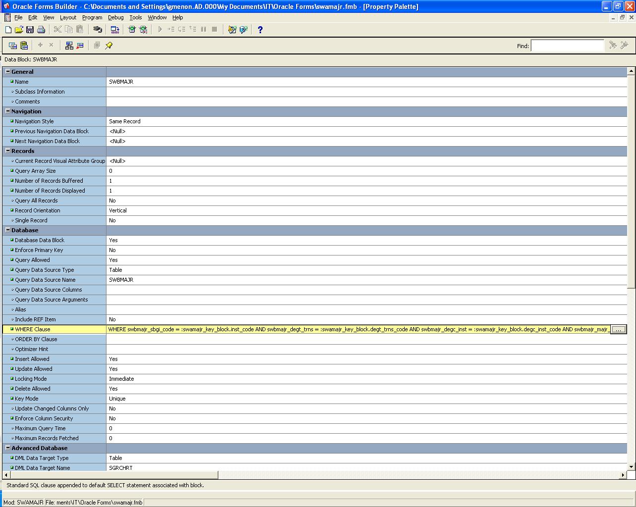

The query is correct, but what I am  trying to say is that within the data block itself, there is no place to put the first part of the query, i.e.
SELECT A.SWBMAJR_SBGI_CODE, A.SWBMAJR_MAJR_CODE, A.SWBMAJR_CONC_CODE,
    A.SWBMAJR_DEGT_TRNS, A.SWBMAJR_DEGC_INST, A.SWBMAJR_YEAR_CODE
    FROM SWBMAJR A
because you can only start typing from the WHERE onwards.

by: geeta_m9Posted on 2009-10-02 at 12:56:16ID: 25481486
It's hard for me to explain, so I have attached a snapshot.

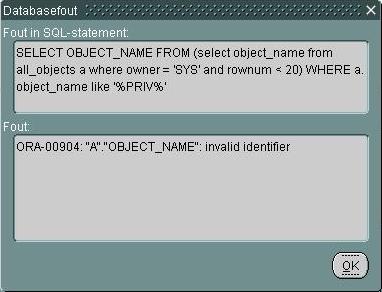

I did some testing
you can't refer to an alias in an "from clause query"  because oracle forms treats it as an inline query (see attached file aliashidden.jpg)

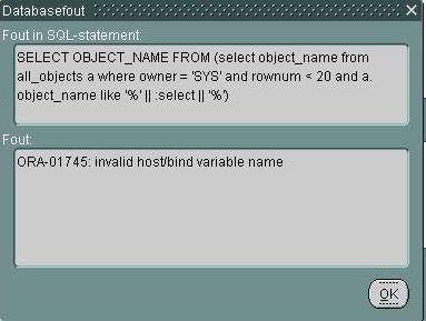

and
you can't refer to a bindvariable in an "from clause query" (see attached file no-bindvariable-allowed.jpg)
