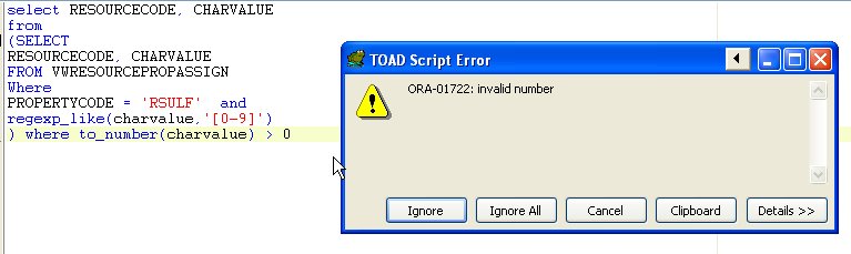

by: finance_teacherPosted on 2009-10-30 at 08:10:22ID: 25703724
sdstuber, attached error happens.
by: sdstuberPosted on 2009-10-30 at 08:14:08ID: 25703764
looks like oracle is "helping" you by pushing the outer predicate into the inner view
which then creates invalid conversions
so, go with my second option (small tweak added, making sure they are numbers)
SELECT
RESOURCECODE, CHARVALUE
FROM VWRESOURCEPROPASSIGN
Where PROPERTYCODE = 'RSULF'
and regexp_like(charvalue,'[0-9]+') -- make sure they are numbers
and CHARVALUE != '0' -- remove 0's
and not charvalue like '-%' -- remove negatives
