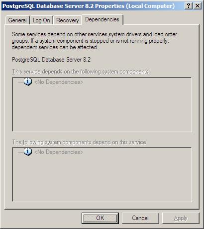

Well, this is weird as on my computer the NetLogon does not appear
in the PostgreSQL service dependencies. (See the images).
It might be that you wrongly installed PostgreSQL.
I suggest you uninstall PostgreSQL and try to install it again and then pay
close attention to the options.
Cheers,
za-k/
