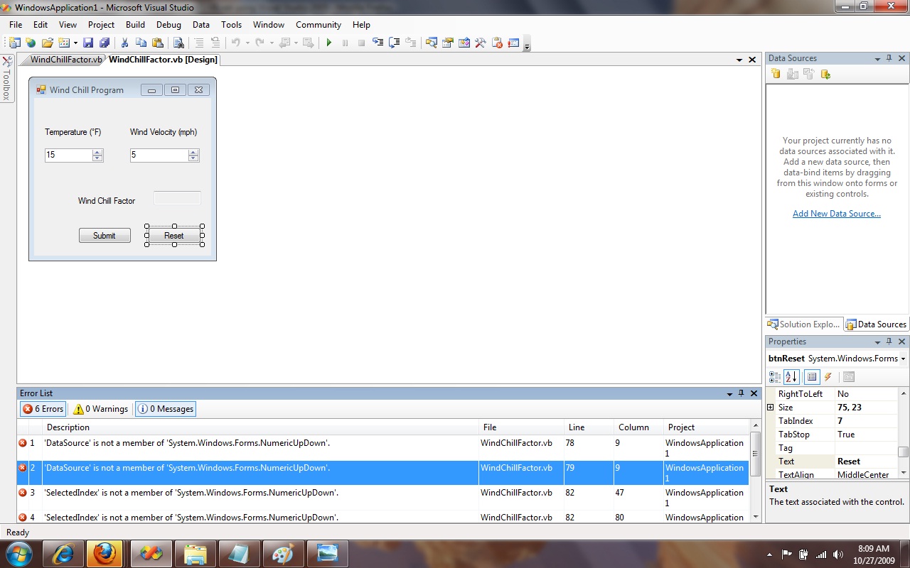

by: seeminglylostPosted on 2009-10-27 at 04:09:02ID: 25670959
What I have is an application that has two NumericUpDown controls and one textbox.  As well, two buttons.  One submits and the other resets.
User chooses a temp from one NumericUpDown control and wind speed using the other control.  The user would then click on submit.  A corresponding wind chill factor should display in the textbox and then a Messagebox.Show() pops a message relating to the data in the textbox.
I am using Visual Studio 2005 and when I attempt to compile what you provided for code, I am getting the following errors:
Error      1      'DataSource' is not a member of 'System.Windows.Forms.NumericUpDown'.
Error      3      'SelectedIndex' is not a member of 'System.Windows.Forms.NumericUpDown'.
Right now, anything that has 'DaaSource' or 'SelectedIndex' is causing errors.

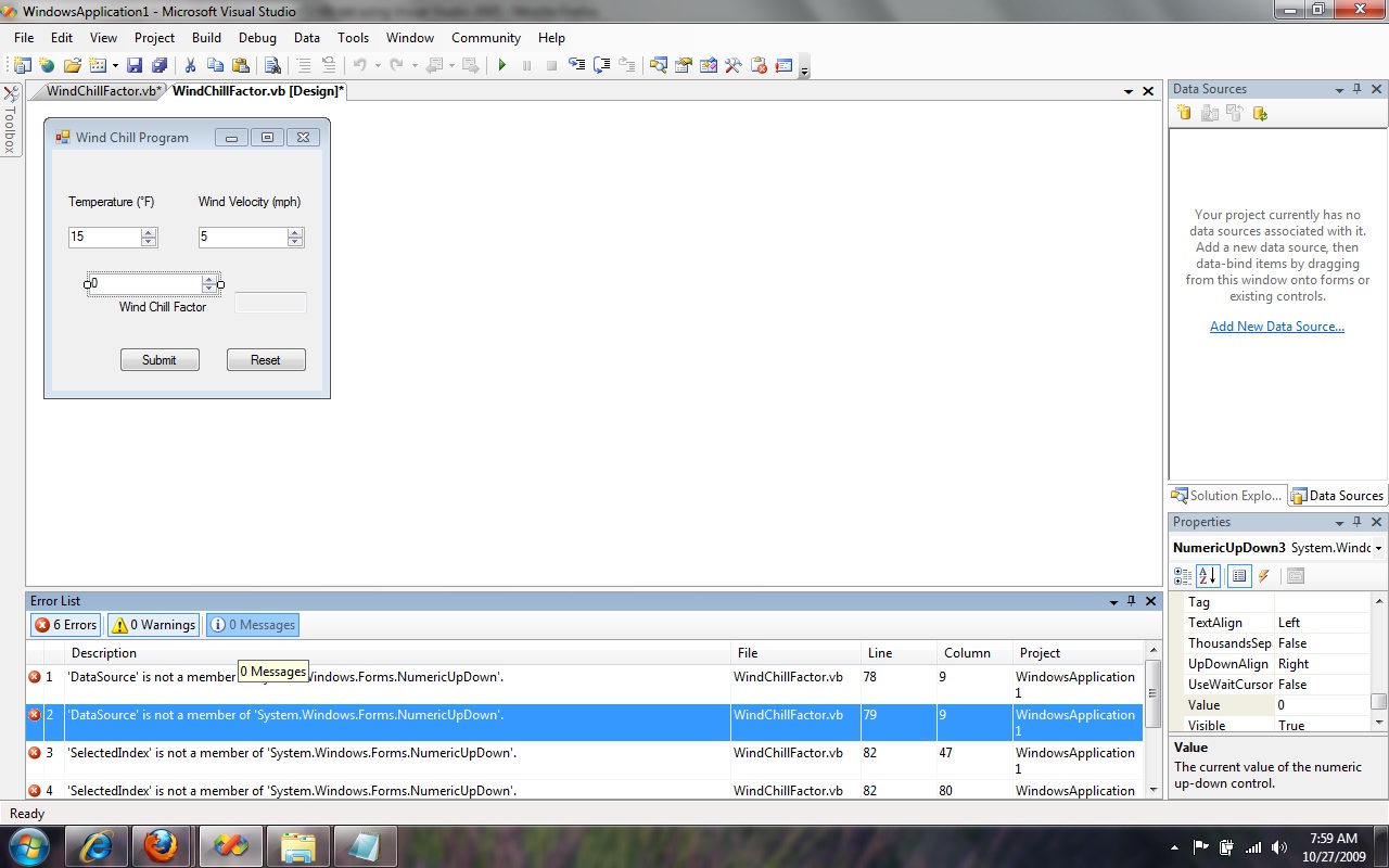

by: seeminglylostPosted on 2009-10-27 at 04:11:25ID: 25670971
Sorry...I attached the incorrect screenshot.  This is the correct one.
by: roma2208Posted on 2009-10-27 at 04:12:56ID: 25670980
Yes my previous code will give you the error because you haven;t mentioned any thing about numeric updown so i have used combobox instead of NumericUpdown.
If you will use combobox instead of numUpDown it will not give you error.

    Private Sub frmWindChill_Load(ByVal sender As System.Object, ByVal e As System.EventArgs) Handles MyBase.Load
        getTemp()
        getWind()
        getWindChill()
        Me.NumericUpDown1.DataSource = intTemp
        Me.NumericUpDown2.DataSource = intWind
    End Sub
    Private Sub btnSubmit_Click(ByVal sender As System.Object, ByVal e As System.EventArgs) Handles btnSubmit.Click
        txtWindChill.Text = CStr(intWindChill(Me.NumericUpDown1.SelectedIndex, Me.NumericUpDown2.SelectedIndex))
        MessageBox.Show("The WindChill Factor is:" & intWindChill(Me.NumericUpDown1.SelectedIndex, Me.NumericUpDown2.SelectedIndex).ToString)
    End Sub

by: roma2208Posted on 2009-10-27 at 04:21:15ID: 25671034
First keep combobox on Ui and change their name as NumericUpDown1 and NumericUpDown2 and now check will it still giving error ?
by: CodeCruiserPosted on 2009-10-27 at 06:04:12ID: 25671903
I think there are much better ways of doing what you are trying to do. I think you can populate a DataTable with the values and then use a RowFilter to find the value you need.
by: roma2208Posted on 2009-10-27 at 06:11:27ID: 25671974
There may be so many way to do one thing but unless and untill you will not explain what you exactly want i can't help. Up till now i have given you the solution according to your code.
If you can tell me your requirement in details then i can help you more.
by: roma2208Posted on 2009-10-27 at 06:13:29ID: 25671989
On submit button click event you have written the static value in textbox like intWindChill(7, 5) .. what should be there exactly.??
by: bhmahlerPosted on 2009-10-27 at 06:29:35ID: 25672145

by: seeminglylostPosted on 2009-10-27 at 06:42:26ID: 25672276
roma2208:  The solution you provided works great using combo.box control.  What I would like to use is NumericUpDown controls instead of the combobox control.
