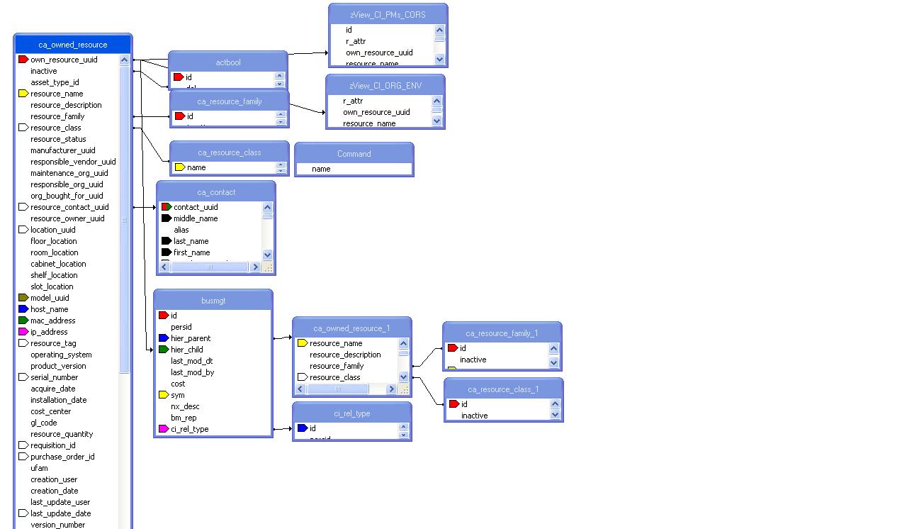

by: almalerPosted on 2009-03-10 at 15:09:30ID: 23852075
I am using a command just for the dynamic LOV that returns 7 rows.  The rest are tables and views.  I attached a .jpg of the tables, views, and the command links above.
by: almalerPosted on 2009-03-10 at 15:27:35ID: 23852185
I created a new report with just one command object using your syntax.  It was quite a bit faster, but I am not sure how to account for the LOVs since the selection is actually in the command object.
