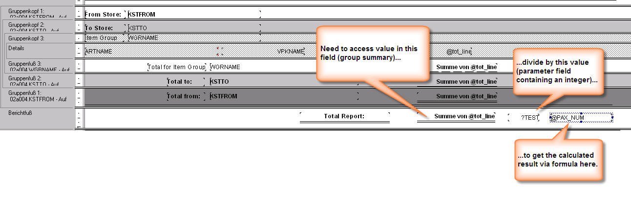

Hello all,
I have a situation where I need to make further calculation with a group summary field. Eg. I'd like to divide it with an integer.
I have created a frormula field but I don't know how to access the value in the group summary (screenshot of intended calculation attached).
Many thanks in advance.
    • 105 KB
    Screenshot of intended calculation

by: peter57rPosted on 2009-08-07 at 06:00:34ID: 25042188
In the formula editor the group summary fields are included in the report fields list on the left panel.
Just double click the summary to include it in the formula (don't type it).
by: PCIIainPosted on 2009-08-07 at 06:05:23ID: 25042219
You can type sum({fieldname}, {grouping field}) to get the same results.
sum({fieldname}) will get the report total sum.
by: PCIRichardPosted on 2009-08-07 at 06:05:43ID: 25042222
The formula for @PAX_NUM should be as follows.
Assuming that this is to go in the report footer;
sum({@tot_line})/{?TEST}
If it is to go in a group footer (or header):
sum({@tot_line},{group_Field_Name})/{?TEST}
