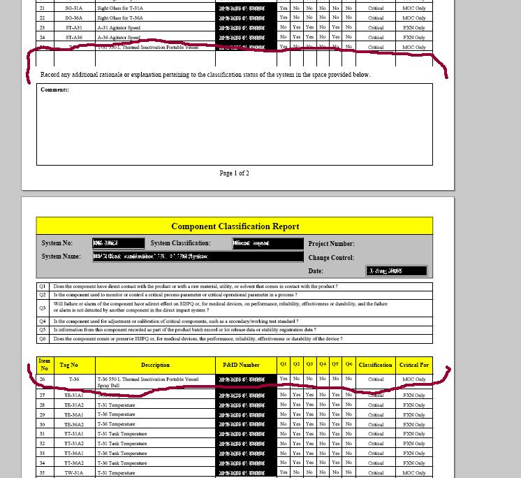

I have a crystal report detail section which I need to keep together.  For some reason it is breaking the rules.
I know I have used this functionality before with success, but it seems that something is causing it to not work in this situation.
The detail in question is a row of a table.   The lines of the table are in the detail and about 12 columns.
The second column is a Text field and the only field that can possibly expand into a second row.
The issue:
when the Text field in the second column expands into a second row the detail will be allowed to go across two pages.
Obviously this only happens if there is enough room on the first page for the detail when it is only one line.  It seems that it makes the keep together judgement based on the size of the detail in the design rather than the data that goes into it when run.

by: obrienjPosted on 2009-08-12 at 01:13:55ID: 25076590
Yes, I have used the Keep Together on the Section detail.
I have also tried putting the Keep Together on the Field itself.  What happens if I do that is that all the "Fields" move to the next page, but the lines start on the previous page.
See attached image.  It shows the lines for the detail start on the first page.  It's then as if it figures out the description column needs two lines and it must keep it together (because I have set it at the field level) and it moves all the fields onto the next page.
Either way, it seems no matter what I do it prints the lines on the first page.
by: PCIIainPosted on 2009-08-12 at 01:47:42ID: 25076752
I assume the lines are drawn in from the group header to the group footer.
This is going to be a pain, but you could try it.
Instead of drawing one line from group header to group footer, draw a line within the group header, one within the group footer and one more within the details section, this means the lines don't 'join up'.
I'd put a second details section below the first, draw the line down into it and then suppress it. This should cause the line to extend when the first details section is grown larger.
The pain bit is getting the three lines to match up in all the sections, particularly if you then resize the sections.
by: obrienjPosted on 2009-08-12 at 01:52:35ID: 25076786
Unfortunately we have already been through that and done exactly what you say above.
This stopped the lines appearing almost every time.
Now it ONLY happens under certain circumstances:
1) Enough space at the end for one more detail as designed, in this case one full row.
2) The detail gets expanded due to the text field growing into two rows.

by: obrienjPosted on 2009-08-13 at 02:29:58ID: 25086539
OKay, I seemed to have found a solution, but I have no idea how.
Basically, while messing about and trying different things I clicked OFF the Free-Form Placement option.  I noticed that this moved everything up slightly and put in place a horizontal guideline.
When I ran the document again it worked fine.  Even when I clicked Free-Form Placement option back on (this did not change back the above movement) it still seems to work.
I even tried making the changes (that I could visibly see), that changing the option made, myself but it made no difference.
So, I have no idea how it fixed it, but seemingly it has.  thanks for all the help, and I will divide the points between all equally since no solution was found really.
