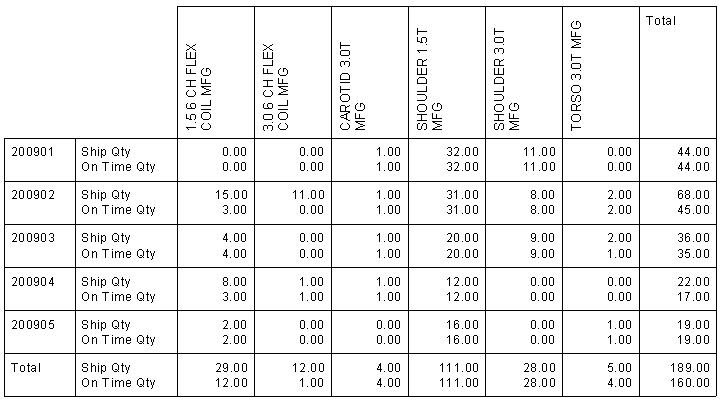

by: MTaftPosted on 2009-08-18 at 08:42:53ID: 25124406
Here is my crosstab data.  Here I'm only compiling 5 days worth (on the lefthand side) and 6 types of widget occured within that timeframe.  There are approximately 30 types of widget altogether and I don't want them all showing if most of them are blank.
Basically, all I want is a percentage column to the right of the Total column that says, for example on the first line, "100%" because there were 44 shipments and 44 were on time shipments.
On the second line, I'd like to see "66%" because 45 is 66% of 48.  See what I'm looking for?

by: CRXIuser2005Posted on 2009-08-18 at 09:55:30ID: 25125214
Ok well you do that simply by adding another summary to the totals and then changing the summary to a PERCENTAGE calc.
Have you tried that? I thought you meant something more advanced that simply adding a simple Percentage Column.....

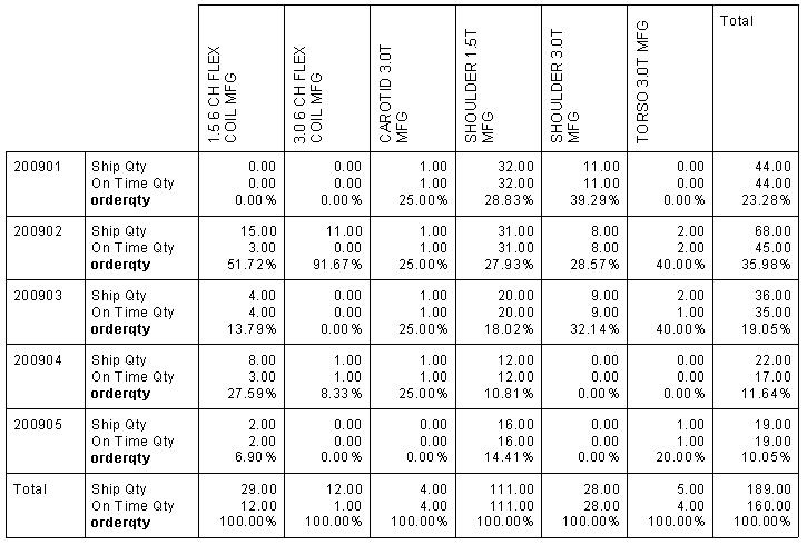

by: MTaftPosted on 2009-08-18 at 10:06:19ID: 25125301
Yes.  I've tried that.  Attached is a pic of what it does.   It gives me what percentage, either in the row or column, each widget is in relation to the total widgets.  I don't give two toots about that percentage.  I want to know what percentage ON TIME QTY is of the SHIPPED QTY.  I don't care what percentage Widget #2 ON TIME QTY is of the TOTAL ON TIME QTY.  See what I mean?
by: MTaftPosted on 2009-08-21 at 08:31:26ID: 25152845
I believe I know the answer to this question, and it is that there may be a way to do this in CR 2008 but there simply isn't in CRXIR2.  Thanks for the links CRXIUser2005.
