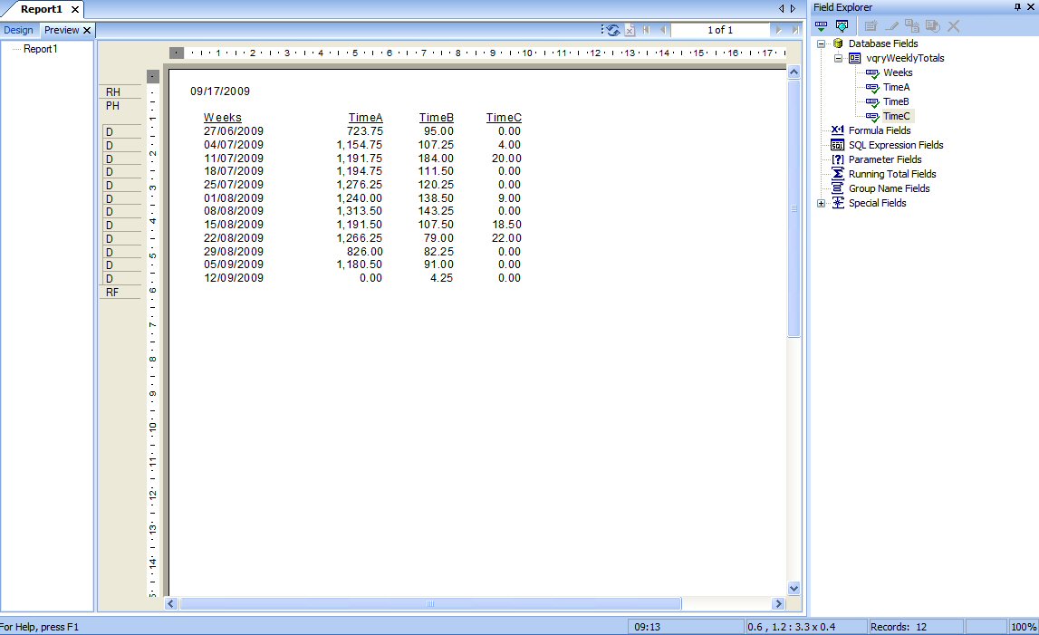

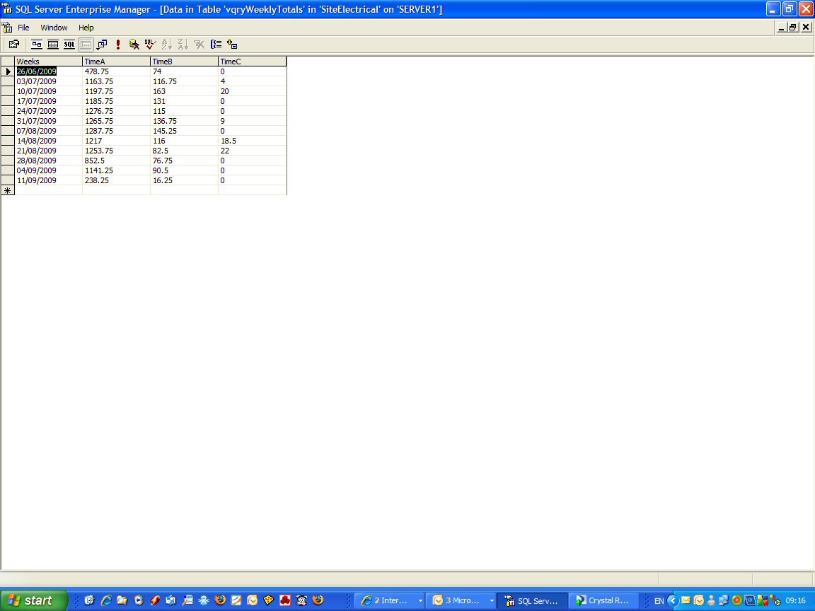

This works fine in SQL but when the query is run in Crystal 11 reports I get different results (seem to be 1 day out) Now I am thinking it is because DATEPART(DW, @pInputDate) gives different results in SQL and Crystal.
In SQL a date of 27/07/2009 give result of 25/07/2009 (correct)
In Crystal a date of 27/07/2009 gives result of 26/07/2009 (wrong)

by: sullym6Posted on 2009-09-16 at 04:25:21ID: 25344230
I should have explained the first day of our week is a Sat and hence the 0-Datepart etc. Either way with the change you sugested the answers are different in SQL and Crystal as above example
In SQL a date of 27/07/2009 give result of 26/07/2009 now a sunday
In Crystal a date of 27/07/2009 gives result of 27/07/2009 which is a monday and wrong

by: sullym6Posted on 2009-09-17 at 02:17:04ID: 25354097
There is a difference as I have proved this already with my results
The result of your query in SQL
Datefirst = 7
Testdate = 11/09/2009
and in crystal
Datefirst =1
Testdate=12/09/2009
I have tried to set datefirst my function but get error this is not allowed.
Sully
