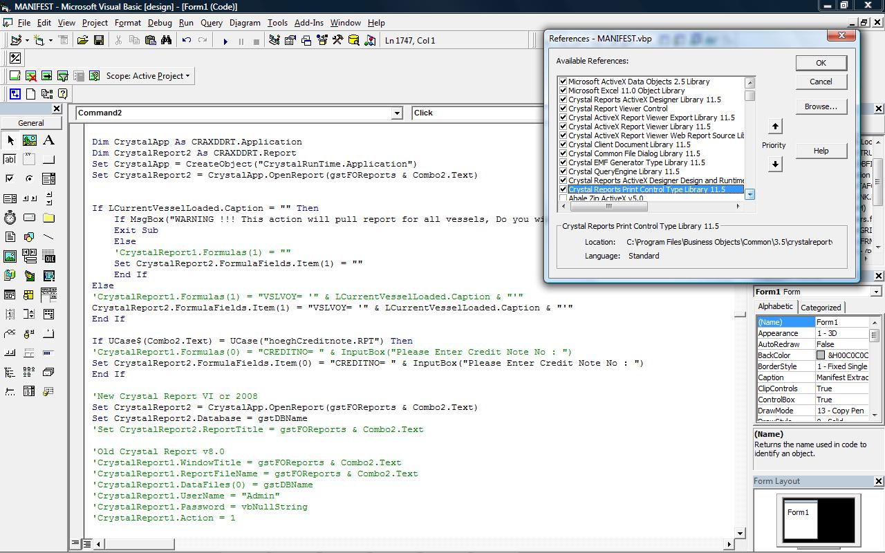

by: gowflowPosted on 2009-11-10 at 13:44:04ID: 25790215
I did install CR XI and found lot of library on top of what I had. Still my program does not run the new version  created in CR 2008. So I looked up a diffrent post where the requester was using the former CrystalReport.Action = 1 to launch the viewer and the solution was with following code:
Dim CrystalApp As CRAXDDRT.Application
Dim CrystalReport As CRAXDDRT.Report
Set CrystalApp = CreateObject("CrystalRunTime.Application")
Set CrystalReport = CrystalApp.OpenReport("c:\tmp\balance sheet.rpt")
I did integrate above code in my program and cancelled all old instances and removed all old library and installed new one.
Am getting following error when I run the code at instruction:
CrystalReport2.FormulaFields.Item(1) = "VSLVOY= '" & LCurrentVesselLoaded.Caption & "'"
Object doesn't support this method.
I appreciate equivalent to following:
CrystalReport1.Formulas(0) =
CrystalReport1.WindowTitle = gstFOReports & Combo2.Text
CrystalReport1.ReportFileName = gstFOReports & Combo2.Text
CrystalReport1.DataFiles(0) = gstDBName
CrystalReport1.UserName = "Admin"
CrystalReport1.Password = vbNullString
CrystalReport1.Action = 1
tks/rgds
gowflow
    • 203 KB
    VB6 sample routine running CR report
by: mlmccPosted on 2009-11-10 at 19:24:06ID: 25792105
