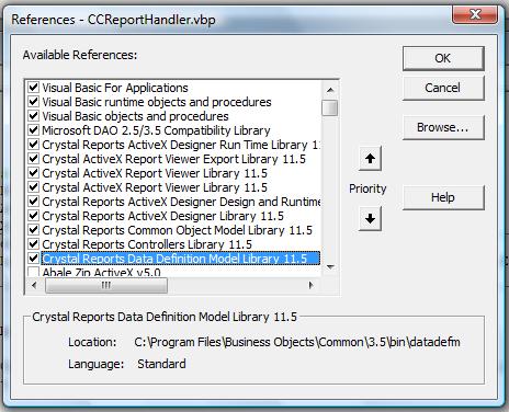

by: gowflowPosted on 2009-11-17 at 10:01:07ID: 25842250
Well it is neither in my case. The report works well and opens thru my VB6 application and run correctly. Same report is ran and being run by users in their version of CR using OCX. Now that I upgraded my VB application to run RDC I removed references to OCX and added following libraries to work with RDC
Under Components I have:
Crystal ActiveX Viewer Library 11.5 - File: C:\Program Files\Business Objects\Common\3.5\crystalreportviewers115\ActiveXControls\CRViewer.dll
Under Refrences I added following:
as per below image. I added almost every single reference to Crystal 11.5 that would make sense. !!!
When I run the program from the source code on my Vista machine all works fine. When I package it thru VB Deployment wizard package it packages fine. When I install on client machine also it installs fine (client has XP) when I run the program it run fine but when I launch a report it give me the Invalid TLV.
This report is built under CR8.
Appreciate your help
rgds/gowflow
by: mlmccPosted on 2009-11-17 at 11:31:22ID: 25843196
I believ you only need the first and third references.  You should be able to delete the others.
In some cases two of the libraries have the same functions so you may be getting a mix of lib1 and lib2 when you call the report.  They may not work together
mlmcc

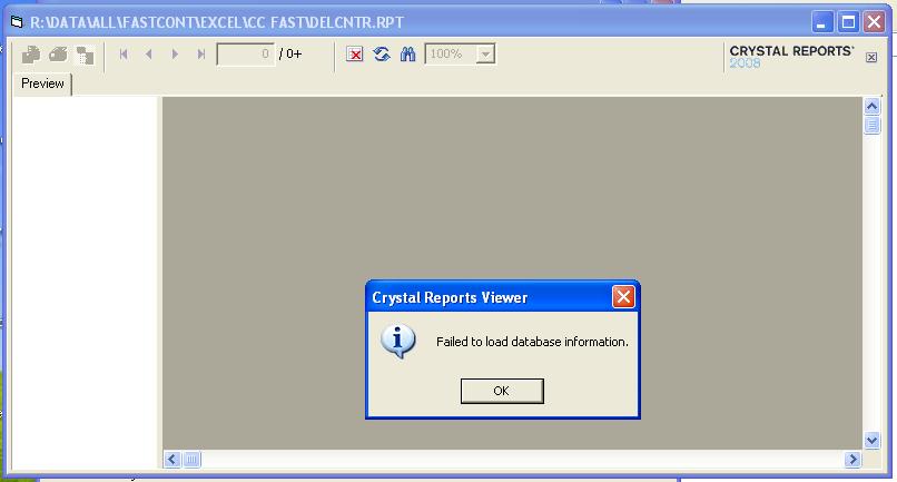

by: gowflowPosted on 2009-11-18 at 03:35:55ID: 25848582
Yes I did that I removed all Crystal refrences except 1 and 3 I do not get the TLV Error any more but
when it launches my viewer I see the form White (no viewer on it) and I get An Crystal Reports Viewer Error: Failed to load database information as per snapshot below. I have added the library for ver 12 which is Crystal Report 2008 I had the same error for Crystal Report ver XI !!
Any idea ?
rgds/gowflow
by: mlmccPosted on 2009-11-18 at 07:01:18ID: 25850400
That indicates the database driver dlls aren't loaded
mlmcc

by: gowflowPosted on 2009-11-19 at 01:50:34ID: 25858887
Well true. After long long search and troubleshooting here is what I found:
I use reports version CR 4.0 Pro and CR 8.0 Pro and some testing sample CR XI Dev and some CR 2008
I noticed that when I load the reports in my VB6 pgm I tested the DllName property of my tables and noted this:
crdb_p2bxbse.dll (DBF files)
crdb_p2bjet.dll (in ver CR 4.0 PRo MDB file)
crdb_dao.dll (in ver 8.0 and above MDB file)
Am having the problem of 'Failed to Load Database Information' when it hit crdb_p2bjet.dll (in ver CR 4.0 PRo MDB file) .
So I looked everywhere on my pc and could not find a trace of this file !!! Any idea where I can get it from ??
I used a trick to overcome this situation as when I get this table I show the report in the OCX version of crystal report and else I use RDC ver 12 with the Library Runtinme for 11.5 (as ver 12 does not have a library for runtime !!!)
WHAT A MIX !!! I prefer to find crdb_p2bjet.dll so I can only use RDC ! Any idea where to find it ?
