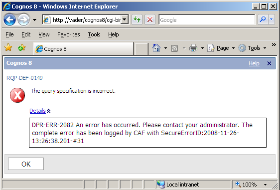

by: IntercareSupportPosted on 2008-11-26 at 07:13:56ID: 23042611
I started just trying out the first function, and I'm sure I'm doing something wrong.  If you look at the screenshot below, you'll see what I'm trying to do.  The "Referral_Auth_Notes" is the field I'm trying to parse.  When I execute this, it errors out.

Do any of the records lack a '/'?  What is the actual error message?
by: IntercareSupportPosted on 2008-11-26 at 10:28:08ID: 23044392
Here's what I'm getting....
by: welchb123Posted on 2008-12-02 at 06:10:50ID: 23076910
Your Cognos administrator need to look at the log files and give you the complete error message.
