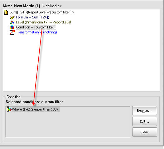

OK how about defining 2 new metrics:
One with a filter condition handling all outliers, one with a filter condition handling all values within scale.
Then you can use both metrics in your report.
by: TolomirPosted on 2008-12-02 at 06:47:02ID: 23077236
so you basically define two new metrics on the original metric with a custom filter respectively

by: TolomirPosted on 2008-12-03 at 13:38:44ID: 23090538
As said use 2 metrics.

I've tried what you suggested. I've created two metrics:
1. One with filter for values within the range of -100 to 100
2. One with filter for values outside range of -100 to 100
Result: Report return no data.
Seems like the metrics exclude each other and nothing is displayed in the report.
