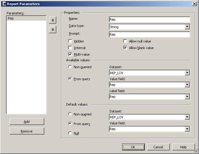

jgv,
I know what you mean when you say it "should" work. That's what I thought too. I deleted it and carefully rebuilt the parameter (using your screenshot to double check my work) and It's still not working. I don't have any way to check (or change) the service pack, so I may be up a creek. Any other ideas before I just tell my user to deal with it?

The most important thing is that the query returning the list used for default values has the exact same items listed in the same order as what is being used to populate the selection list. If you have the same dataset hooked up for both then that should be a no brainer. I confirmed that this works using SSRS 2005 service pack 2. If you are not on the latest service pack or an earlier version of SSRS then you may be out of luck as there's nothing else that I can suggest...sorry.
There's an outside chance that using a view will get this working so it's worth a shot. If you are on an earlier service pack (which is the source of the problem) and you do not have access to installing it then you at least have a reason to give the user for not being able to help.
Just to be sure, I put together a very simple report layout that you can use to test with. If this works to select all then the problem is with the query or the way the parameter was setup. If it does not select all then it's very likely your version of SSRS.

by: jgvPosted on 2008-12-03 at 16:38:13ID: 23091793
The way you describe how you have it setup it should work. Using the same dataset for the list selection and default values should automatically select all items in the drop down list. I did test it to confirm. This screenshot shows how the parameter was setup.
param setup
