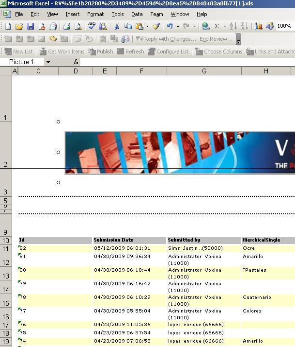

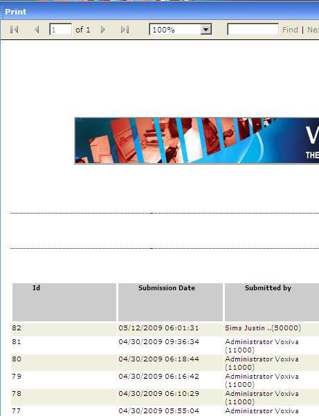

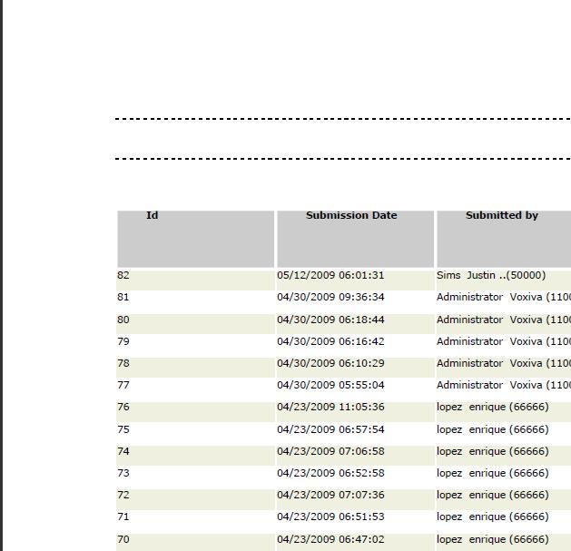

I have a control ReportViewer in a web page (rwWithImage.JPG), this page have two export mode (excel and pdf). When I exported a pdf the image header not shown (rwWithImageToPdf.JPG) , but when export to excel the header image show (rwWithImageToExcel.JPG). I need show image header when i exported to pdf

Not sure about report Viewer, but this is a common problem with Cognos products, and it's caused by the fact that in Excel or HTML, the server merely sends the URL down to the client program; its the client that gets the image (either Excel or your browser).  But in PDF, the server itself has to go and get the image in order to add it the PDF that it's building.  This tends to cause problems, because servers usually have strict controls over their ability to go out to get data from other servers.
by: nolbertaPosted on 2009-06-09 at 13:10:14ID: 24585201
I am using: visual studio 2008, the language for program the report is RDL and for visualize the report i use ReportViewer. What can I do?
by: nolbertaPosted on 2009-06-09 at 14:50:55ID: 24586208
the image is created with
RDLImage rdlHeaderImage = new RDLImage("HeaderImage", imageSource, UrlHeaderDescription);
then the image is add in object pagefooter
RDLPageFooter rdlPageFooter = new RDLPageFooter(rdlFooterImage.getRDL());
my question is: if the export to pdf support object image. Note that export to excel it's work fine
by: AnobePosted on 2009-06-10 at 14:28:12ID: 24596746
PDF export supports image. Set the source property of image control as 'Embedded' and it should work.
