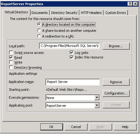

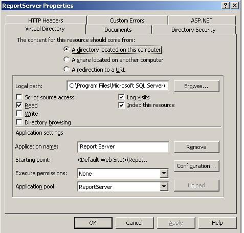

by: Techno-Man-ukPosted on 2009-08-26 at 02:05:22ID: 25185551
something I have just checked.
I have VMware setup for testing purposes and took a copy of my SQL server a few weeks back when the reporting services was working.
I have just switched on the virtual server and the reports work fine I have looked in the IIS config and there are tabs missing from the IIS config compared to my live server so I think this is a good step towards why the reports are not working on the live SQL server, I have attached a screen shot of both the virtual and live IIS config.
by: Techno-Man-ukPosted on 2009-08-26 at 02:55:27ID: 25185799
seemed this was the problem
How to switch between the 32-bit versions of ASP.NET 1.1 and the 64-bit version of ASP.NET 2.0 on a 64-bit version of Windows
