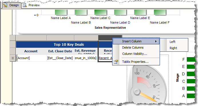

by: crm_infoPosted on 2009-05-26 at 08:17:26ID: 24474133
When you click inside the grid, you'll see a header above the table (sort of like the header above Excel columns).  Right-click on the header and choose Insert Column and then Left or Right depending on where you want the new column to be inserted.  See image.

by: crm_infoPosted on 2009-05-27 at 03:57:49ID: 24481606
The application is Visual Studio (Business Intelligence Design Studio - what I think you have been working in).  The screen grab is a result of exporting the .rdl file from CRM, importing it into a Visual Studio BIDS project and editing it.  Some of the customizations that you see are newly available in SQL 2008 only (such as the gauge).  The report was originally part of the Analytics Solution Accelerator, distributed for free by Microsoft via www.codeplex.com.
But the area that you're interested in is the grid that reads "Top 10 Key Deals" - this is probably formatted in a similar manner to the report you are trying to edit.  I clicked inside of the grid to reveal the headers above and to the left of the grid.  I think right-clicked the column header that I wanted to insert next to which brought up the pop-up menu.
