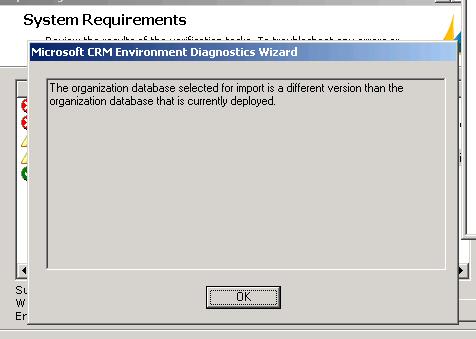

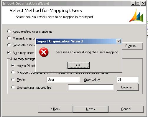

I am trying to make a CRM 4 development environment.
In my production environment I have my SQL server 2005 with the database and have a web server with the front end CRM server installed.
In the production environment I have made a virtual copy of the sql server and I have installed CRM server on the same server which is fine, so all is contained one the one box.
I have tried to create import an new organization after the install and point this to the database on the server but I get the following error messages can anyone help.

by: feridunPosted on 2009-09-08 at 03:34:27ID: 25280335
Did you ensure that the new CRM installation is patched to the same Update Rollup as the production system?
by: Techno-Man-ukPosted on 2009-09-08 at 03:39:01ID: 25280369
argh no I haven't I know that in production it's Roll up 6 maybe this is why?
by: whoajackPosted on 2009-09-09 at 07:27:12ID: 25291621
You have two issues. One is the build is different. The other is that one or more user mappings did not complete. The build, you can install to have the same as production and then focus on the user mappings.
For user mappings, it sometimes just doesn't find the users. You can just remap each user that shows blank mappings to the same or a different user if you like.
For your situation, you need to first look at which users did not show up. Is it one, several, or all of them?

by: feridunPosted on 2009-09-09 at 08:56:46ID: 25292594
Very likely. install Update rollup 6 on the development server and try the import again.
by: Techno-Man-ukPosted on 2009-09-10 at 07:07:26ID: 25300346
Hi updated the version to rollup 6 and worked fine thanks for your help.
