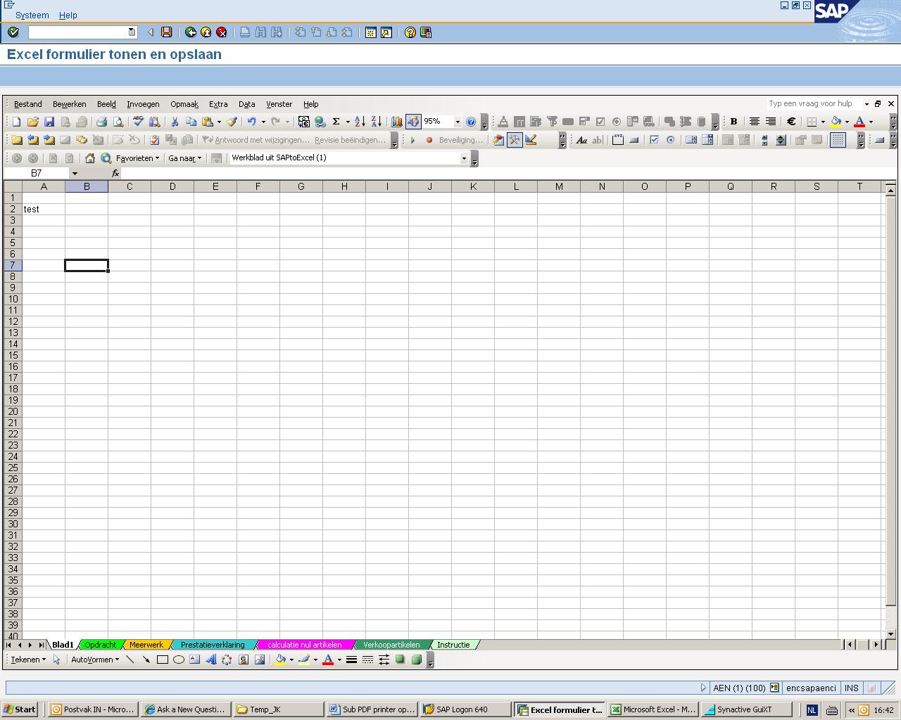

The application fills the SAP-data into the Excel form. To do this the user hits the button, SAP gets the template of the form and the SAP data are filled. The Excel form is shown 'in place' within the SAP user interface. The Excel toolbar showed below the SAP Toolbar.

* A screenshot attached to this message shows how the SAP screen looks when the Excel form is opened (I'm not sure if I may 'publish' the exact form. I therefore made a screenshot with a blank worksheet).

screen shot of the MS Excel form shown in SAP
