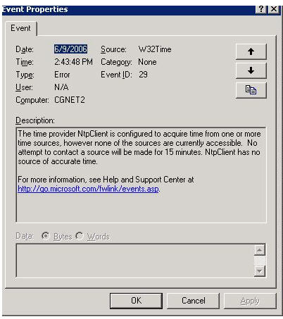

Like I mentioned before, the server updated the daylight saving time by itself. Yes, I am aware that the Attendance Rx software relies on the server system time, but what I don't understand that why the time is not automatic updated to terminal.  The server time system seems correct.  I just checked the event viewer on my server, and I noticed the w32time error.  You can look at it, and please advise.

by: sulliman24Posted on 2009-03-09 at 17:33:41ID: 23842639
I just realized you never told me what server you are using. I found another article with a possible fix that refers to the Event ID 29 specifically, but it is for Windows Server 2003.
http://windowsitpro.com/article/articleid/85534/jsi-tip-10315-your-receive-multiple-event-id-29-errors-on-a-mscs-microsoft-cluster-service-cluster-that-is-running-windows-server-2003.html
Event Type: Error
Event Source: W32Time
Event ID: 29
Description: The time provider NtpClient is configured to acquire time from one or more time sources, however none of the sources are currently accessible. No attempt to contact a source will be made for 15 minutes. NtpClient has no source of accurate time.
To workaround this behavior, make sure that the Windows Time service is working in NTP (Network Time Protocol) mode:
1. Open a CMD.exe window on the PDC emulator.
2. Type the following commands and pressing Enter after each line:
net stop W32Time
REG ADD HKLM\SYSTEM\CurrentControlSet\Services\W32Time\Parameters /V Type /T REG_SZ /F /D "NTP"
net start W32Time
