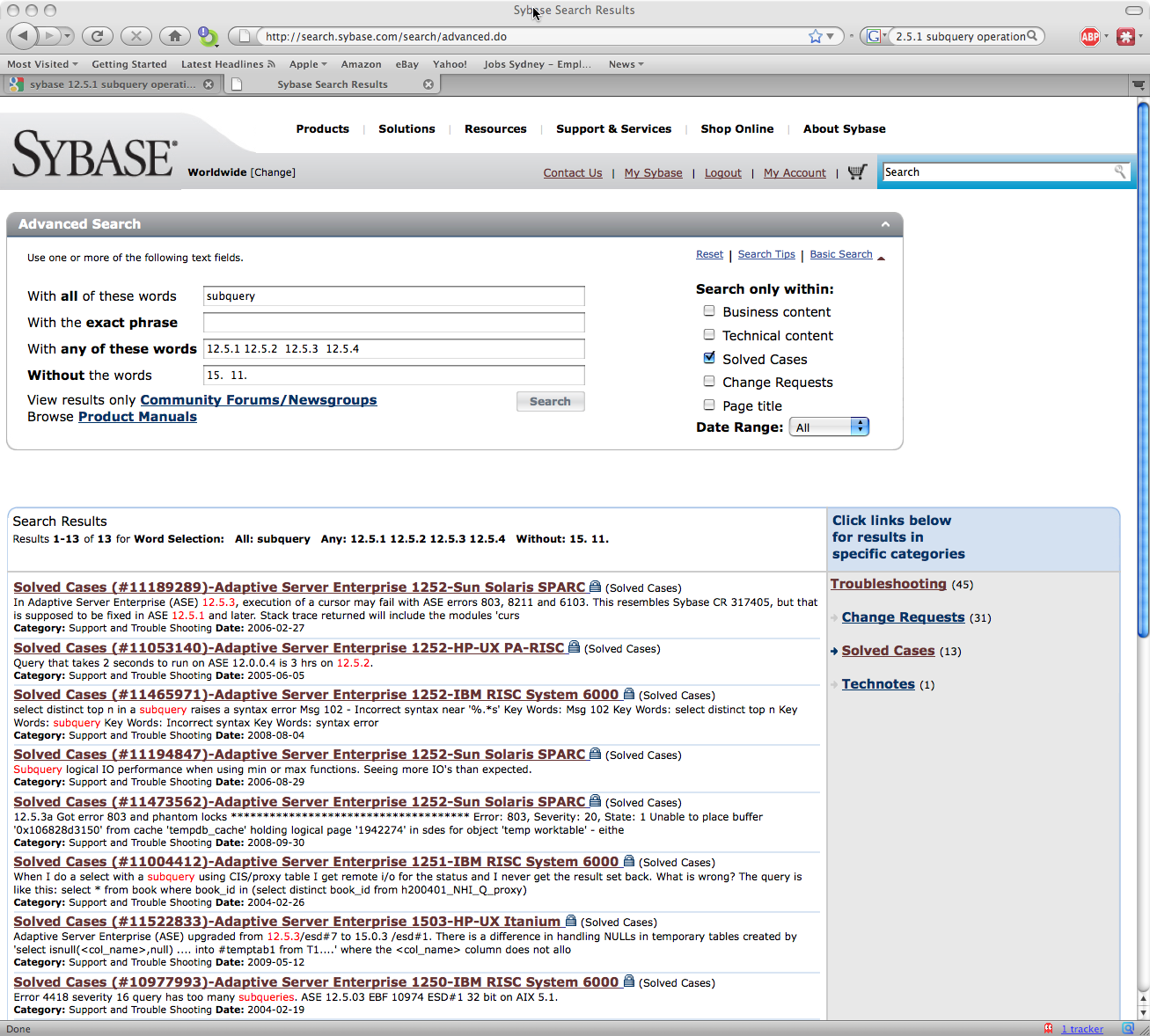

by: IncisiveOnePosted on 2009-07-02 at 19:22:42ID: 24769391
Trying to "confirm with some detail" is turning out to be harder than I thought, since you do not have access to Sybase Support (where it would be easy, and you can get the info yourself).  I cannot give you the info from same without breaking contractual agreements with Sybase (we are Sybase BSA Partners).  Note the lock symbol.
Here is the first page only, showing the search criteria for solved cases that I used, "12.5.1" through "12.5.4" excluding "11" and "15", including "select" (and "subquery" in the second attachment) ... there are 377 solved cases to go through.  That's solved cases, not reported problems.  Even the first few items are telling, and indicative.
Anyone who stays with a version older than 12.5.4 EDS #8, while knowing this information, needs to have some documented reasons for doing so.  But trying to work out problems re the operation of select or subqueries being changed between 12.5..1/12.5.2/12.5.3/12.5.4, is now a documented (from Sybase), complete and total waste of time.
