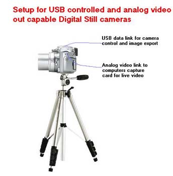

by: RDAdamsPosted on 2008-03-26 at 12:35:08ID: 21215309

Ok this is going to look like a lot to swallow but its a take on the same them from a different angle perhaps...
I am a stop motion animator and capture hi-res stills in sequence but also need to see the 'live' image for reference in animating.  As you have realised DSLRs are not the best option because unlike a digital compact the shutter is closed until you take the shot (see point 5 for existing workarounds).  My workflow/setup is more or less as follows:
1) I use a canon powershot or similar, a pc laptop, stop motion pro (this is good software - cheaper alternatives exist), the canon remote capture software and a DAC (D.igital A.nalogue C.onverter ) made by 'Dazzle'.
2)  The Powershot is connected to laptop with two cables: (a) a standard USB, and (b) a cable from the cameras 'video out' socket that goes to the DAC.  The DAC is then connected to the laptop via another USB cable.
3)  'Connection (b)' is 'live' and outputting to stopmotionpro for reference.  It is maximum resolution is PAL SD 720x576 and is pretty pixelated quality in my opinion because it is coming from the LCD video out of the camera and also going throught the DAC converter.  In theory you could just grab frames with this in stopmotionpro and export as .avi etc. but then you aren't taking full advantage of the cameras resolution and quality.  So...
4)...'Connection (a)' is wired to the canon software and when you grab it takes a full resolution image with any settings (focus/aperture/exposure etc) you have set for the camera (i.e. this allows you to take frames at up to the maximum resolution and quality of your digital camera which will invariably be MUCH better quality than any webcam solution.  The canon software captures frames to a specified folder and numbers them in sequence.
5)  There are options to take advantage of your DSLRs superior specs and lense by mounting a webcam ('spycam') that peeks through the DSLR viewfinder for your reference image.  You would then go ahead and take the high res version with the capture software as before.  BUT there are numerous technical issues to be accounted for here that its not quite worth going into just now (e.g mounting the 'spycam' image flicker etc).  I have posted two images of how the setup looks incase your not quite with me.
As for controlling the movement etc...youre looking at specialist motorised tripod mounts etc I suspect but perhaps thats another story. =o)
Apologies for the length but hopefully theres something of use amongst that lot!?
by: RDAdamsPosted on 2008-03-26 at 12:43:49ID: 21215409
Depending on your budget and expertise this looks like it may work as well or better.  The only thing would be it doesn;t give you PTZ control.
