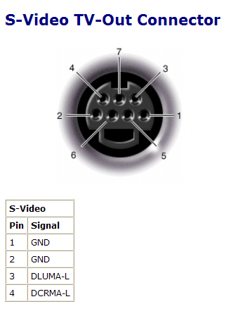

by: MASQUERAIDPosted on 2009-01-19 at 14:14:24ID: 23415118
Yes, my mistake - the 1525 is a 4-pin s-video output (see below)
The s-video doesn't carry audio hence the extra 3.5mm stereo jack at the laptop end (which feeds the red and white RCA plugs)
This would do it http://cgi.ebay.com/ws/eBayISAPI.dll?ViewItem&item=260346362395

by: MASQUERAIDPosted on 2009-01-19 at 14:45:54ID: 23415366
For less that four quid it's worth a punt! :)
Yes it should work fine - Dell used to include these with their Latitudes which I always thought strange when it was personal users who most often wanted to hook up their TV's as displays.
What I'm interested in is the fact your current arrangement that (if I've read this right) is connected to the VGA out on the left side works for you old screen - is this a PC monitor?  In which case that would be expected - but if it's a TV with a composite input like the set that currently isn't working then it's worth checking the make and model to see why.  If it's an LCD screen you need to get the computer to match its native resolution - if it's a CRT you need to make sure the resolution and refresh rate your laptop is using is compatible with one the TV can display.
