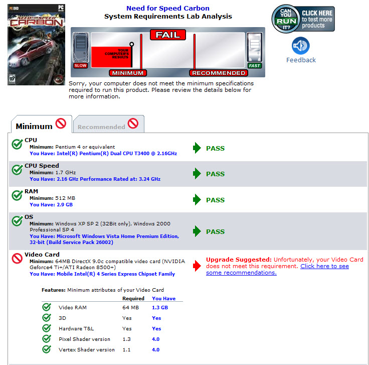

I installed the latest driver and then tried the 'Can you Run It' tool which I found here..
http://cyri.systemrequirementslab.com/srtest/download.aspx
It fails on the Video Ram , though bizarrely it reports the system as having 1.3GB .

yep, - it runs perfectly on my Dell laptop with W7 but I have Geforce Go7900s - so I don't think it is a Vista problem and it's not RAM or processor so it must be that the Intel Graphics doesn't have enough dedicated memory - just uses shared and the game doesn't like it.
